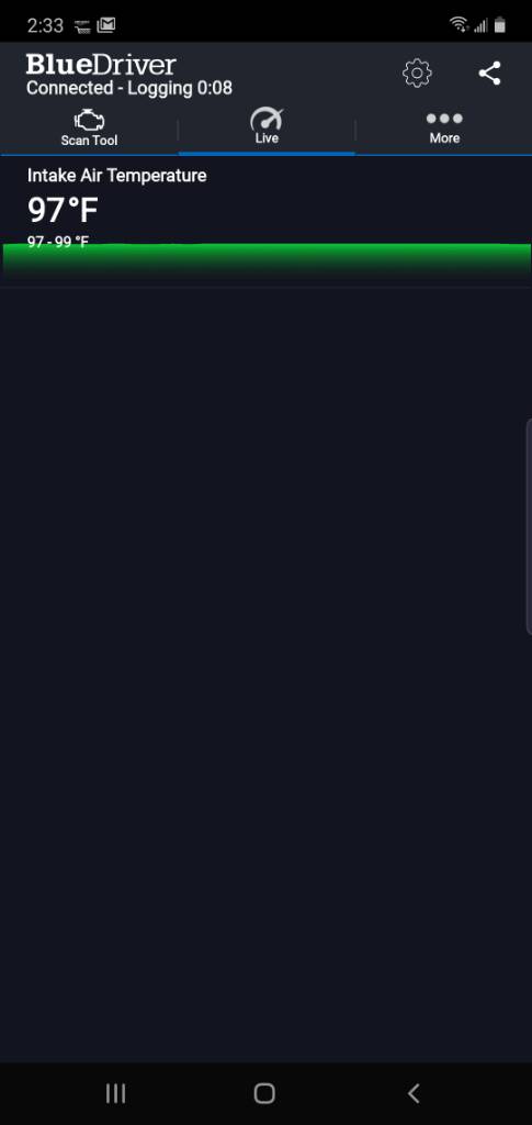

Speaking of major heat-soak, is there a way to check your CAI Temps?
Wish I would have checked before swapping out. It does read it. Can get some on road live measurements at some point. Just chose the CAI temps for the screen shot.

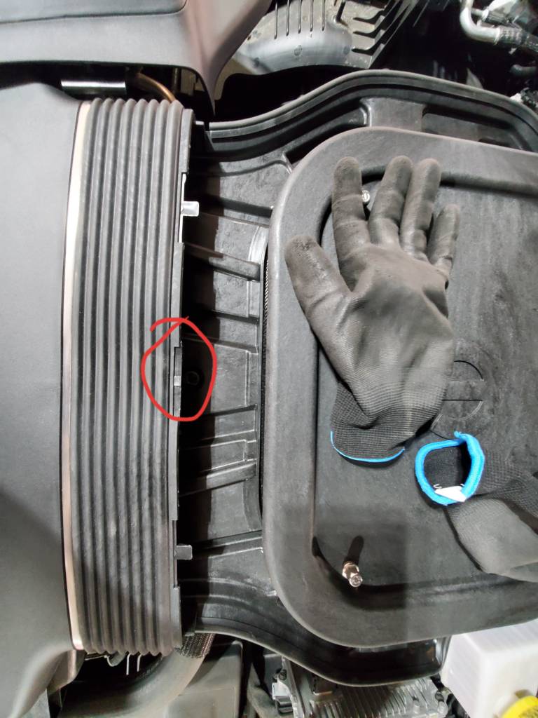

Also notice a tab was missing in the middle where the top wedges down from. Doesn't look like it was broken, just left off. Anybody else's this way?
Yeah it's suppose to be like that. When I was installing mine I notice it looked different from the instruction manual. I definitely looked online to make sure it was suppose to be like that.

I'll plug in my Blu and monitor the CAI temps live and see what I get average for a while. Hindsight is 20/20 and wish I had done it pre install. Hell...I wish I had 20/20 to begin with.
Is this with the MOPAR RamAirflow installed? I have a Blue Driver as well and my truck is stock. I can take some comparative measurements with my truck. I guess the only thing that we would need to figure out is differences in outside air temperature. I'm in Florida, so it doesn't really get cold here. Not to mention, I'm at sea level and you appear to be quite a bit higher where the air is a little thinner.
  • Like
Reactions: J4U
A touch different bring in Denver, yes
Would be great if someone in Florida or Denver had the opposite of us. Think it's too many different variable's to compare ours but numbers are always good.

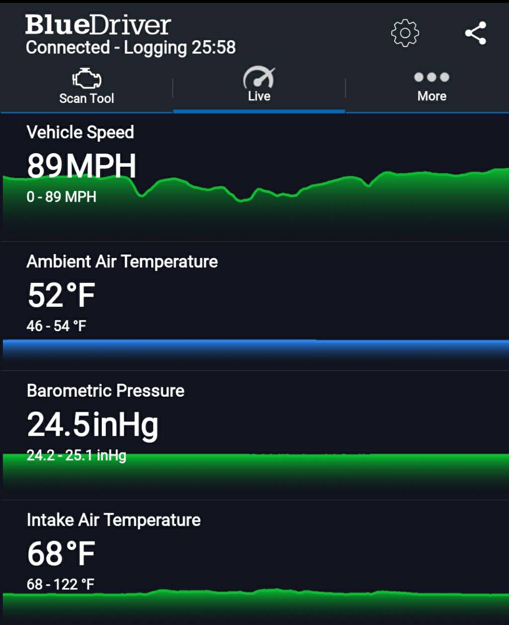

Logged a return trip through downtown highway traffic and also on toll road. Took advantage of higher speed limit to stay under 10 over with no traffic. Gets pretty close to outside temps the faster you go obviously.
The highest temp was recorded after starting up from the initial trek to destination. Engine was still hot.
Could actually see when I was drafting behind another vehicle, the temps would raise a bit and then lower once I backed off or passed. Pretty neat but dangerous so won't be watching that again. Almost 26 minutes were logged live.
