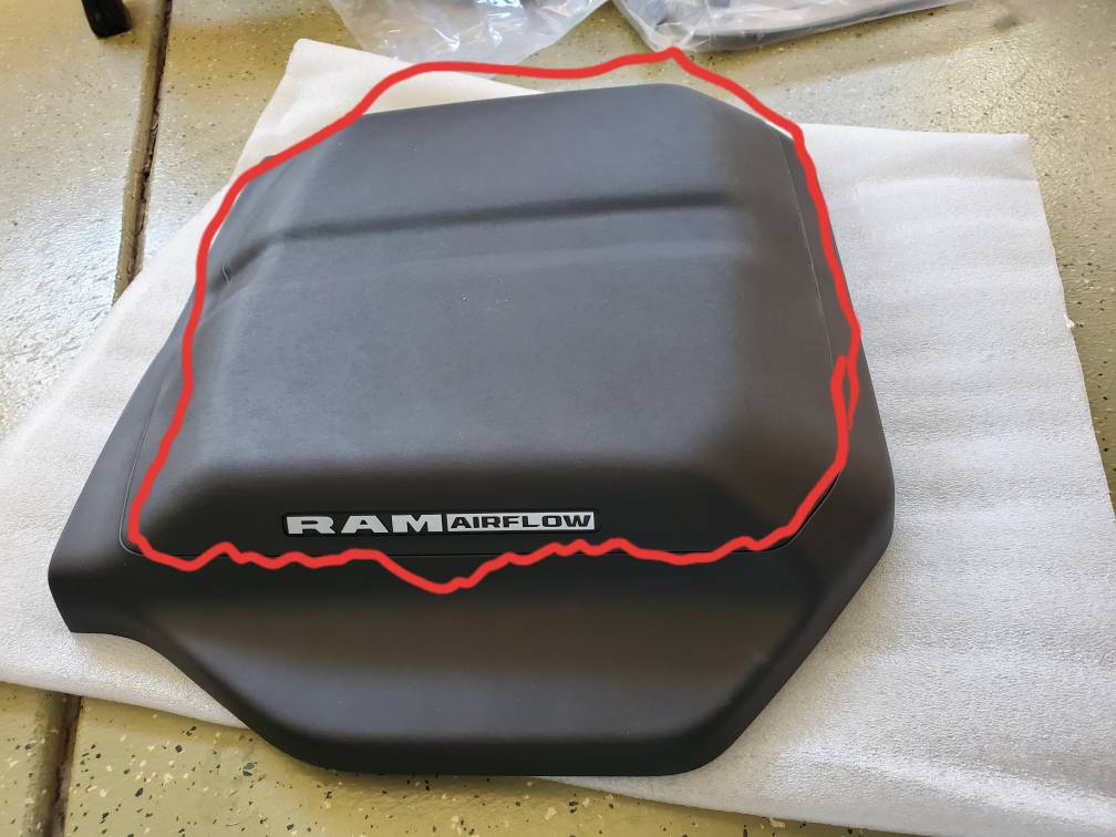

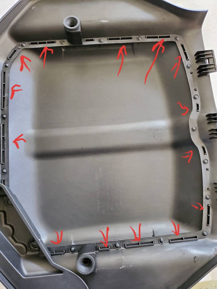

Too tired yesterday to install mine, but I opened it this morning. Probably install it after services, but did notice something.
The top cover has a seam around the top half and pressure tabs underneath. As if the top half was meant to be removed at some point. I wonder if that is there for some future possibilities? Hood scoop, Ram'd air, etc.
Why else would you mold it with a seam unless it's cheaper than molding it as a one piece cover.
Just a thought.
The top piece has to come off to change/clean the filter after installation ;) Maybe I am missing your question, but when I look at the pics of the RAM AIR, the top piece is one molded piece that then attaches to the base unit. Is your's different?RAM AIR.jpg
The top piece has to come off to change/clean the filter after installation ;) Maybe I am missing your question, but when I look at the pics of the RAM AIR, the top piece is one molded piece that then attaches to the base unit. Is your's different?View attachment 39216
The top cover
Here’s the base. The top/cover does have a seam. View attachment 39217
That image looks familiar LOL
The top cover
2 pieces cheaper than 1 ..
but, it leaves those of us creative types to be able to modify (and void the warranty) to create a seal to the RAM AIR HOOD if we get one. (Those melted/weld points would need to be drilled out of course)
Figured that's what it was, but the mind started wondering.
