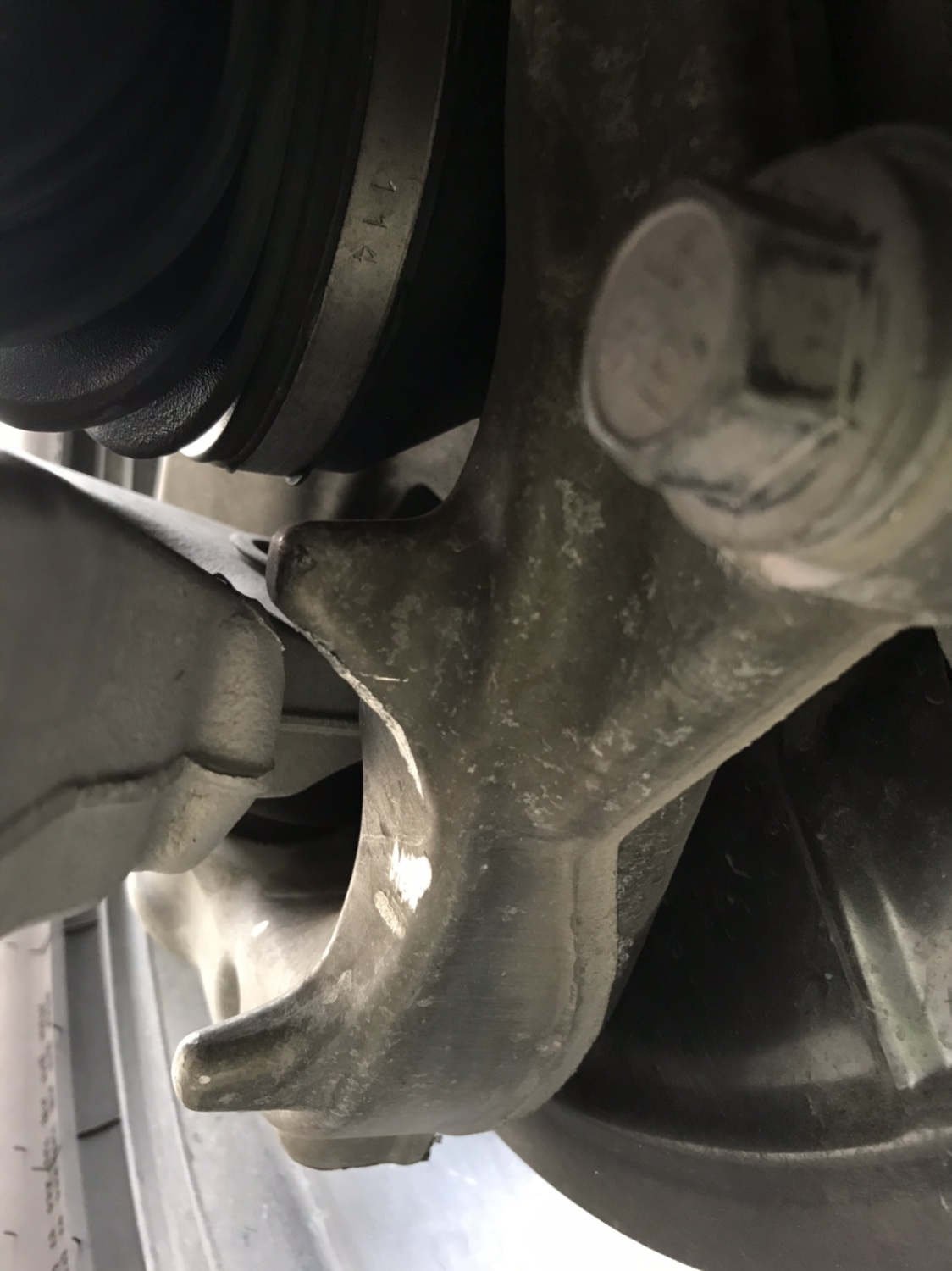

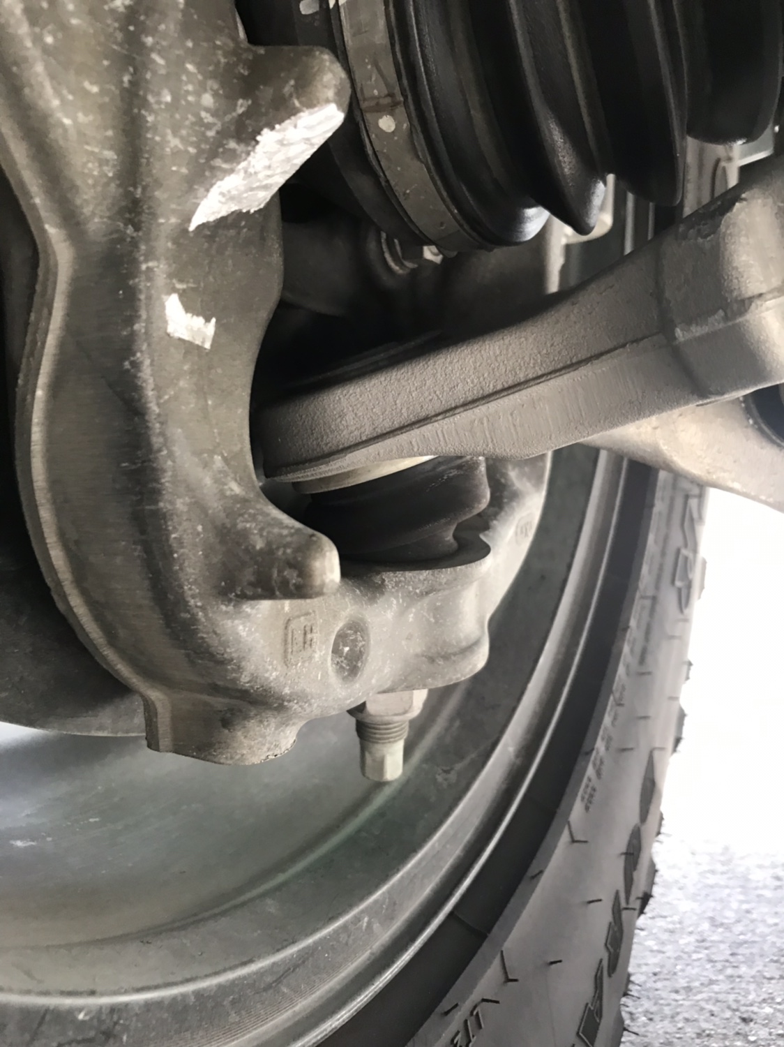

After level, my lower control arm contacts the horns on the steering knuckle. Instead of going “full lock” the arm hits the horns on the knuckle and pushes the front of the truck down. Is anyone grinding these off or doing any other mods?

It’s a Rebel with air with Daystar leveling spacers. 2” lift up front. If you take a look at the arms, the space between the horns isn’t very large.

It appears that those protrusions are a "soft stop" to prevent binding and/or over extension of the suspension at full droop while turning. I assume you are running the air suspension at top height and running the spacer? If so, have you tried lowering it some to see if it stops contacting? If not, definitely something to check.

That makes sense on full droop. The current interference happens in normal mode, 2” higher than factory off-road group height. It makes the front of the truck droop at full lock due to the horn angle.

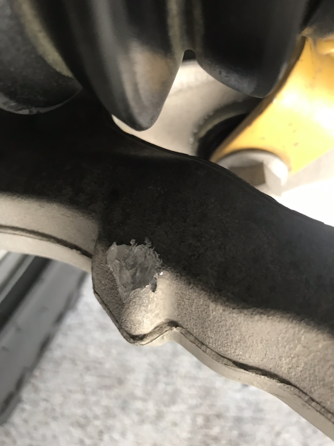

Just curious, is everyone with a leveling kit (air suspension or standard coil) seeing the same metal contact/wear that is posted in the pictures above?

After significant amounts of reading a research, I just installed a combination of bilstein 5100s (clip 5- 1.7") and small 1.5" tophat spacer and UCAs to create a similar amount of lift to the RL 3.5" STT with hopes of a ride closer to stock than the RL 3.5". When pulling the truck off the lift I notice my front end dipping when turning on full lock both sides. After inspection, I am having the same problem as described above where the horns on my knuckle are contacting the lower control arms. I haven't read of others having this issue so just looking to see if anyone else has this problem or insights.

Confirmed I have the same contact on my truck. That definitely explains the dip I experience. Really wondering now what happens while turning at lock while driving... perhaps a u-turn, for example.

Thanks for the replies, all! After that initial post 5 months ago, I’ve just been driving it. If I’m in an unusually tight turn situation, I’ll go that extra bit and dip the nose. I avoid it otherwise. You’ll learn the feel. As I suspected, everyone has this issue with this amount of lift... just nobody realizes it. If you want the dip to stop, need to grind the upper horn. That opens the question to “what happens when at full turn angle and then you go full droop?”. The factory suspension has those horns to slightly straighten your wheels under that condition.
