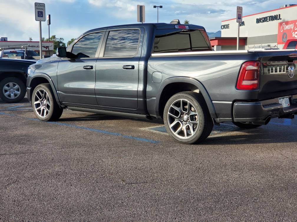

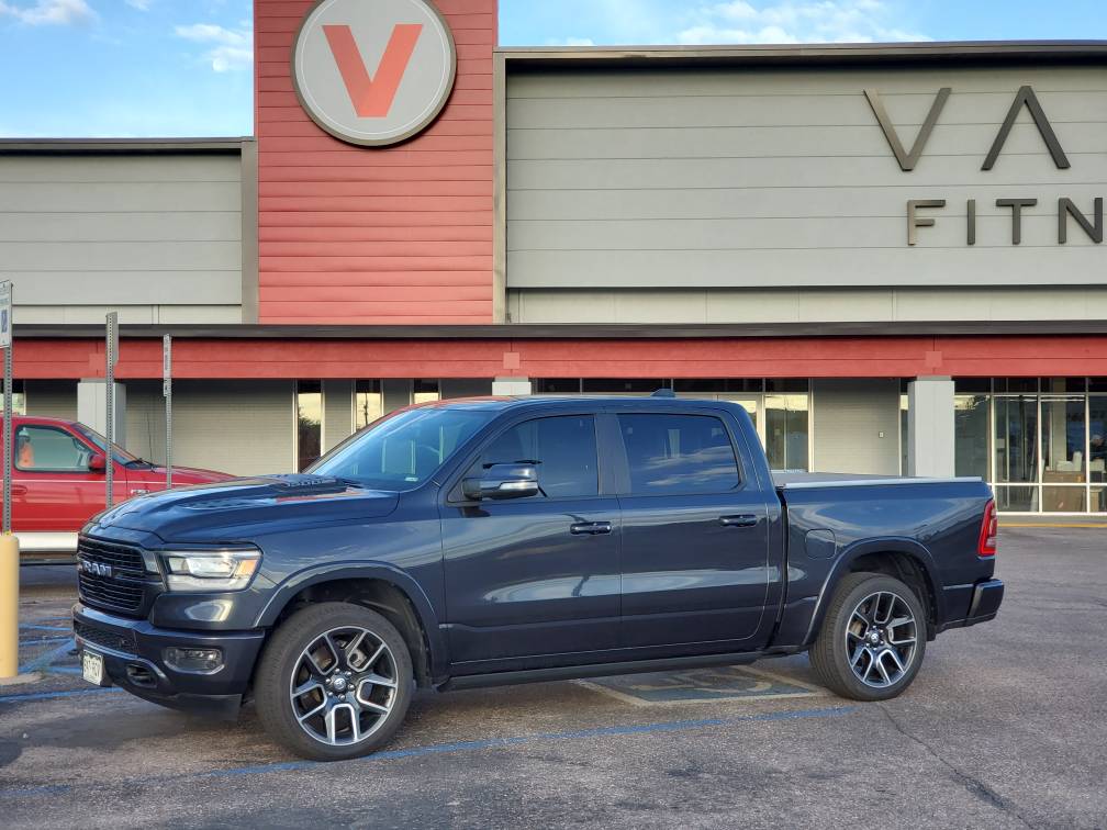

Yea I reused the rubber spring isolators. But I didn’t grease them.
			Look at it like this, the top 3 coils sit in top each other. The coil is about 1/2” thick so to get 1/2” drop, one full coil needs to come off.
Wheel liner removal was more for visual on the nubs on the top spring placement. Old age and eyesight may have called for this step.For mine I had to do one side at a time, disconnected the bottom shock and the sway bar and I was able to remove the spring without removing the wheel or liner. I also still have 1” of rake.
	Looks great!!!She's dirty but working hard. Like the new stance.
She looks great, I'm glad you got through it. Really, it is worth the time and very little money for the look in the end.
