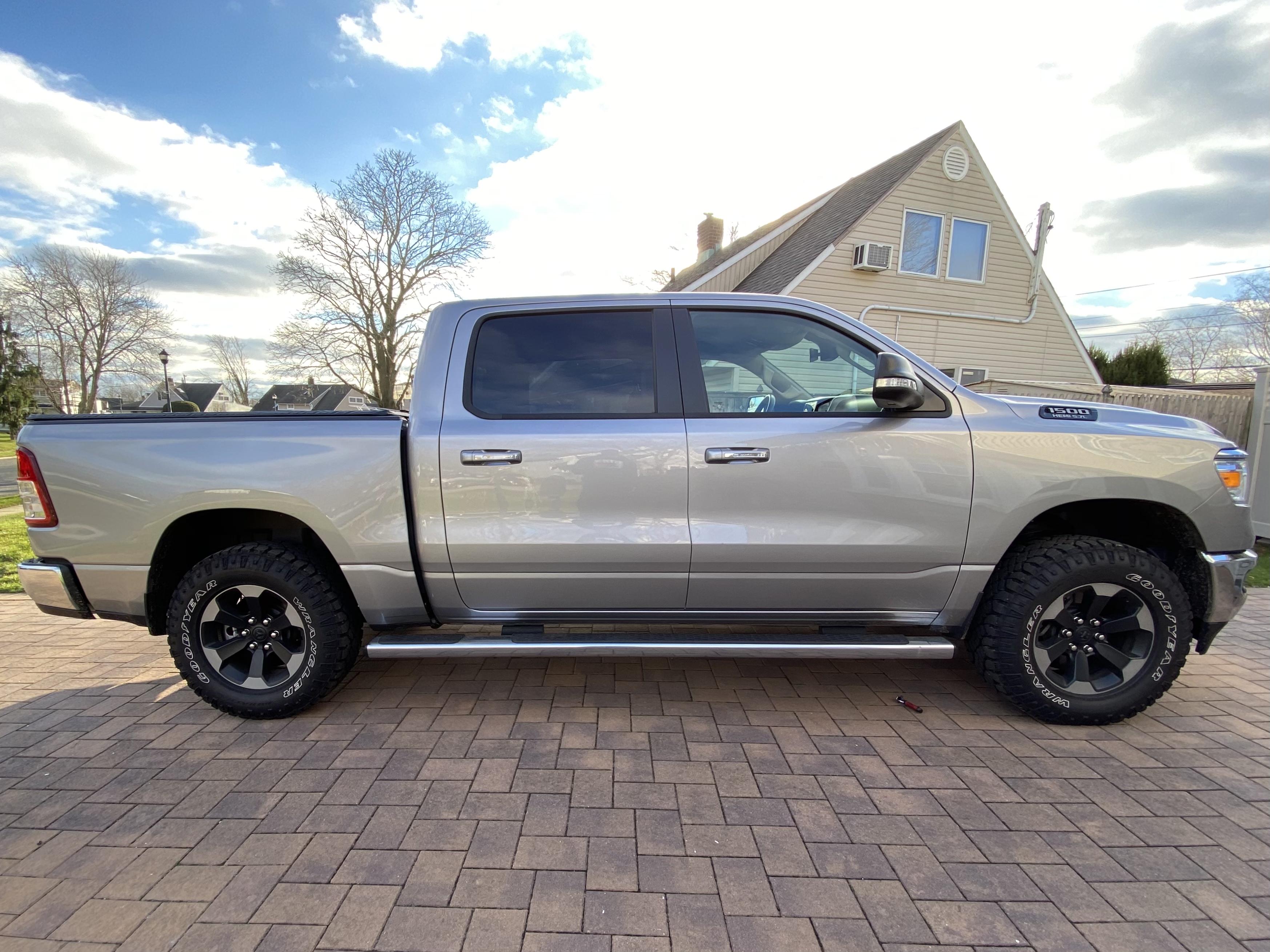

Thank you for all the solid information about these boards. I'm looking at buying them right now. Did you get the ones I linked here?I went with the APS iBoard Polished Aluminum boards. I have the old school chrome bumpers and 20 in Chrome wheels, so I wanted a bit of chrome on the boards to tie it together.
The way these are shipped, and I imagine that it is similar with a lot of these boards, the brackets are shipped in pairs in a plastic bag. I noticed that there were some places where the black paint from the factory was thin or down to metal from the pieces rubbing together in shipment - I am talking about the mounting brackets. The boards were packed individually and were fine. Anyway, I hit the brackets with some satin black rustoleum in the small exposed areas before doing the install as a just in case.
Very easy install with quite a bit of adjustability front to back, in and out. I went with them all the way in as I didn't want them sticking out. And at 6 in wide, I can step well on the board even with them tucked in. Wife approved setting as well. View attachment 73643View attachment 73644View attachment 73645View attachment 73646View attachment 73647

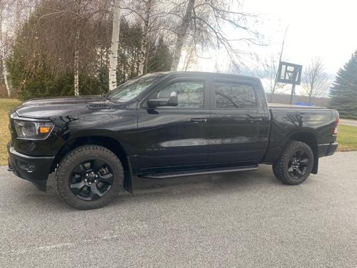

Yesterday I got lucky with moderate temps up here in the north country and finally got my Go Rhino D6 boards installed yesterday. Originally I had ordered them from Real Truck then brought them to get sprayed with bed liner but when I picked them up there was a dent in one of the steps. They were brought to the shop still packaged and apparently the tech didnt notice the half dollar size dent and sprayed them anyways. Real Truck was great and sent out another set. If you buy these plan on an extra 1/2 hr to go to the hardware store to get some 3/8 lock and flat washers that will fit the bolts they send. Both packages did not have the correct size for the bolts.

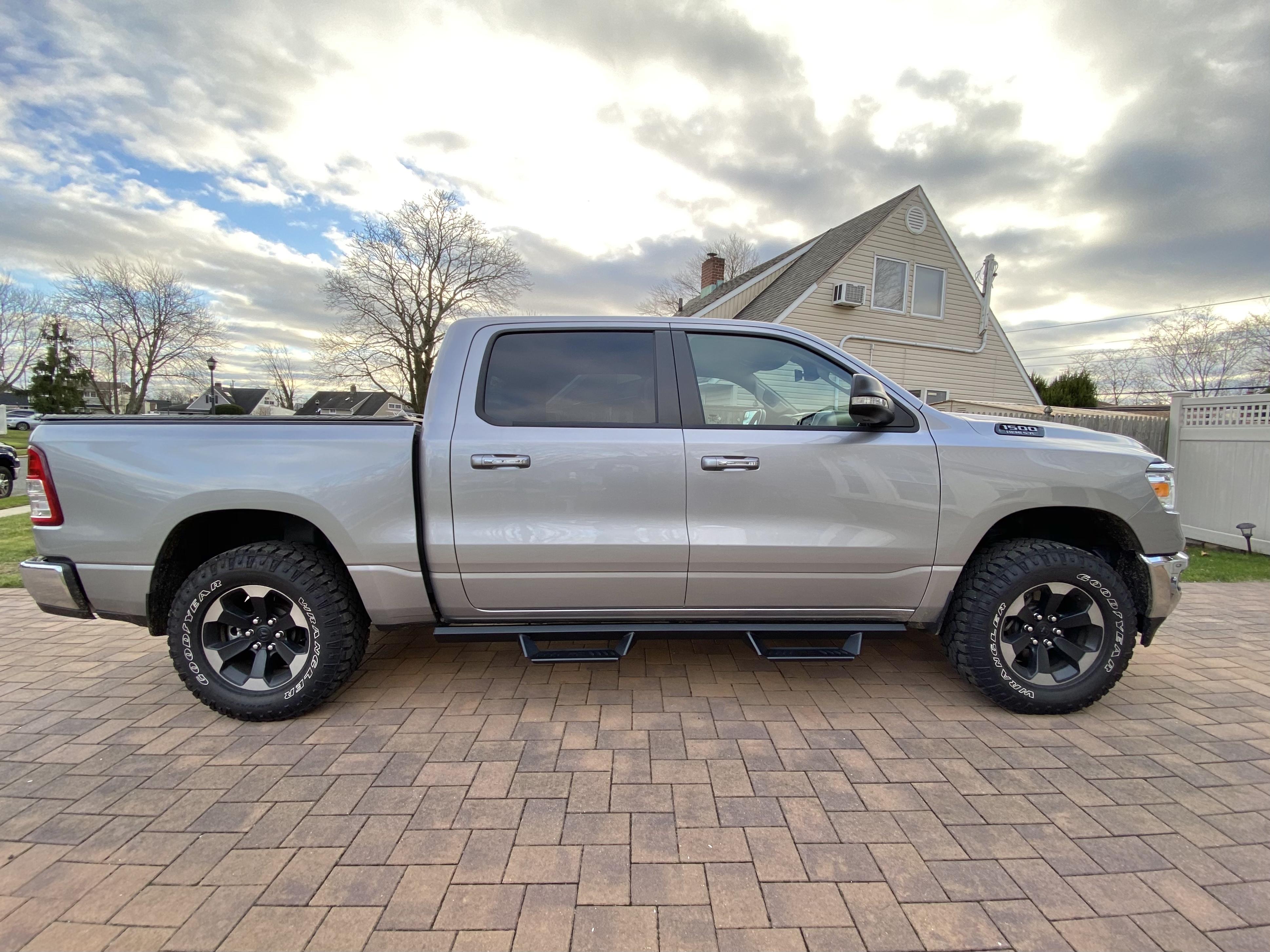

Already posted in the “what did you do to your Ram today” thread, but figured the pics may be helpful here also -
GoRhino Dominator D6 Rhino Lined
View attachment 74125View attachment 74126View attachment 74127View attachment 74128View attachment 74129
Very happy with how they turned out. If anyone wants a particular angle or anything I’ll snap some more pics.
I had the same concern and was really hoping I could find an option I liked made with aluminum. However, that didn't happen so I took a chance with the D6 boards. They come powdercoated...but to be honest the finish was crap, so I had them bedlined inside and out. If I can get five years out of them, I'll be happy.I need to buy some running boards, but struggling to make a decision. Really like the look of these D6's and the Go Rhino RB20 with the bedliner coating, but I'm worried about buying anything steel since I live in MN and deal with salt. It feels like my best option is to sell a kidney and get the Mopar off road ones. What's the general consensus on how well some of these steel running boards hold up over time?

Everything I had read or watched prior to installing them said to remove the paint first, so I did that with a wire wheel brush attached to my drill. Super easyNo issue with paint on the "threaded studs" the boards attach to? That was a problem for many.
