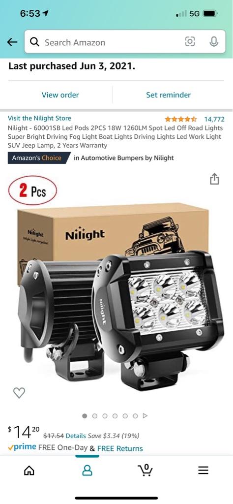

Wanting to pull trigger on some lights are theses Walmart ones worth the price??? And how are they holding up?
I got the same Nilights off Amazon and they are working fine but the one on the right has gotten some moisture in it. It looks like I can open it from the side and wipe out the moisture and then seal it back up.
Ya I had mine for a while now no problems. So bright at night people flash their brights . Can see for at least a hundred yards in pitch black.

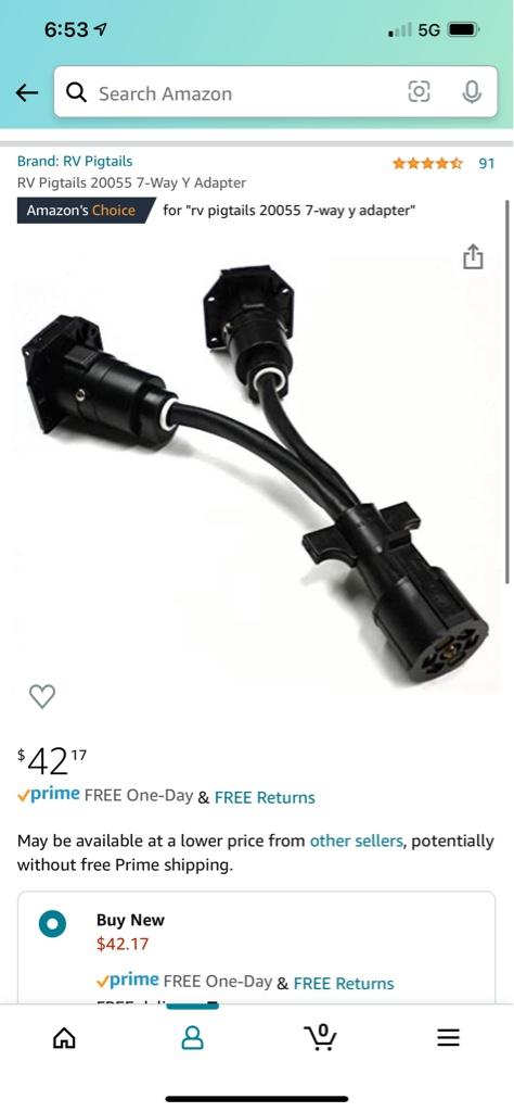

Can someone help. I ordered these two parts. Are the pigtails correct? Or did I get the wrong one?
I am not sure what you are trying to do but here is a lot of information and options on reverse lights.
Mounting in the bottom bumper and using a plug n play kit while splicing into that harness so I don’t have to splice into the factory wires. I looked through those and I couldn’t find what I once found lol. Just want to see if anyone can chime and see if I can use the harness to plug into the back of the bumper with this.
Let me try looking again
