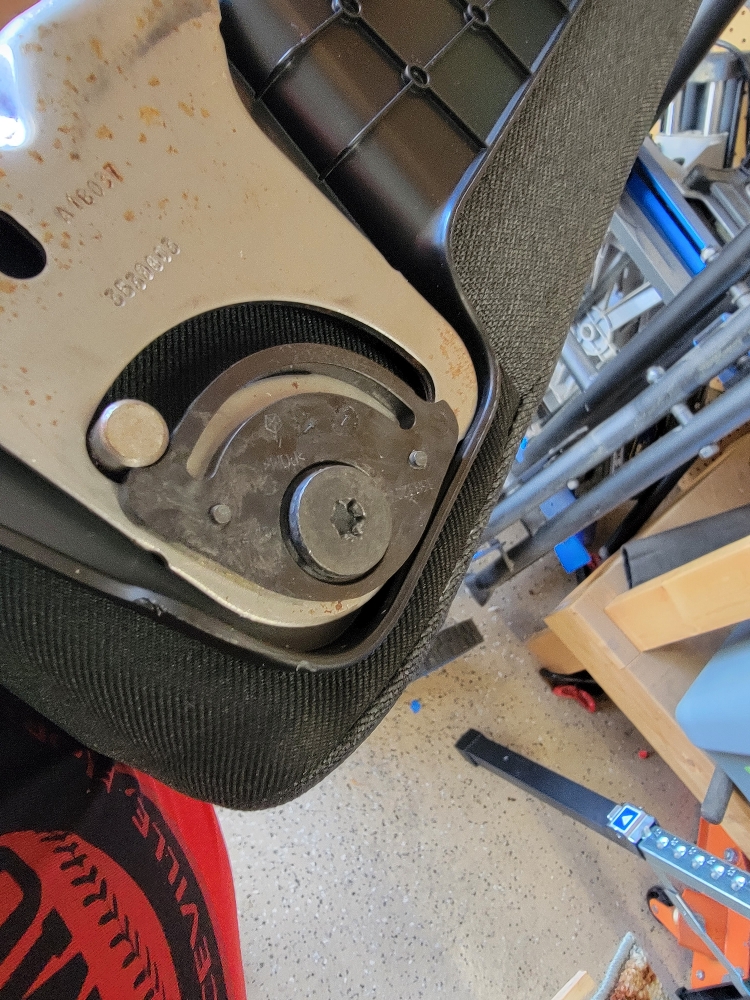

Now starting Katzkin installation, already done 1/3 rear seat. Could anyone say me the order to install leather on rear armrest in 2/3 rear seat my Big Horn?
Remove bolts/nuts from behind rear seat and remove arm rest.
Remove side adjustable brackets from arm rest. I think it was a torx 30

Pic of side bracket. Only one I took of that part so I could remember how to put it back together.

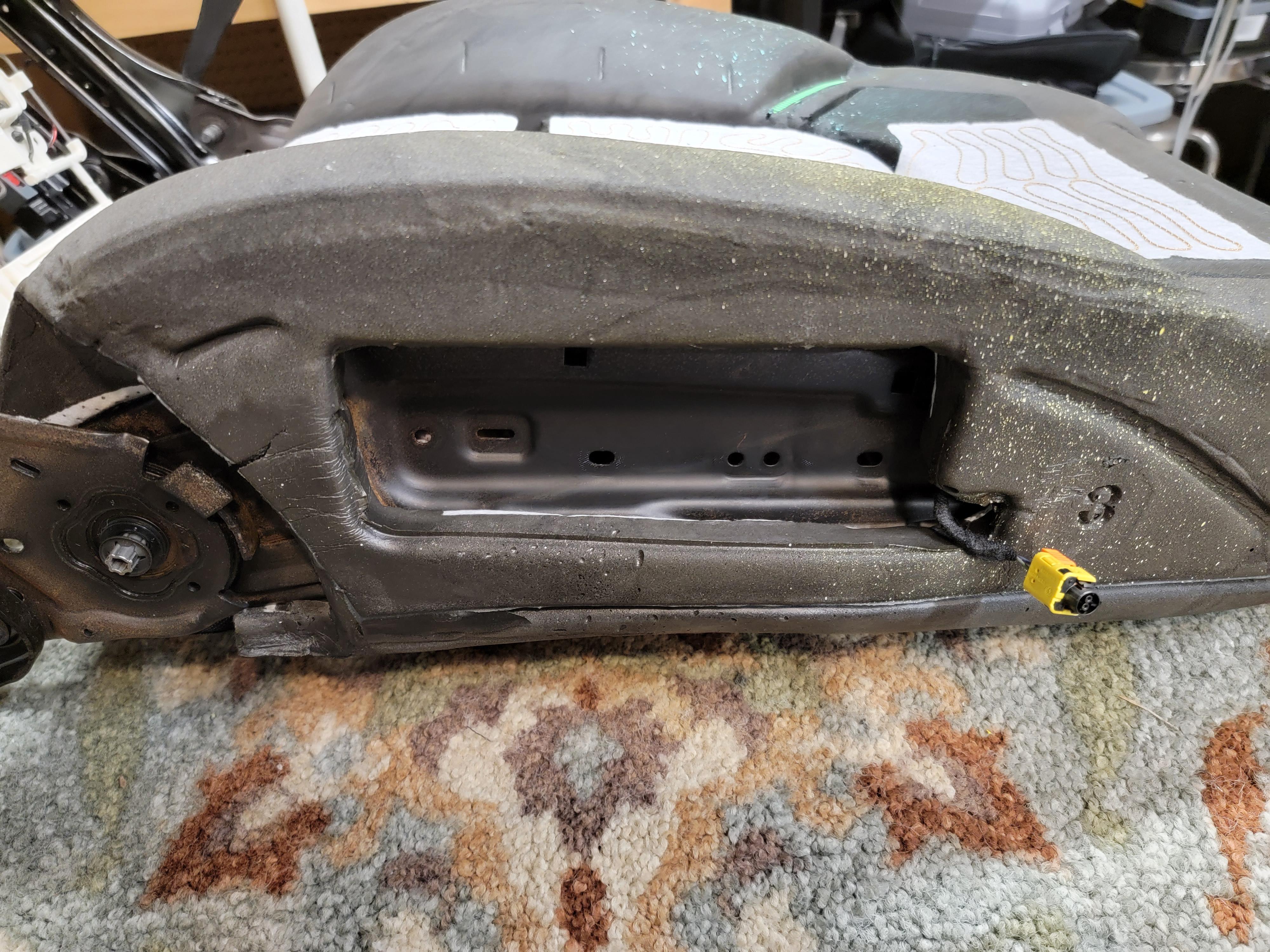

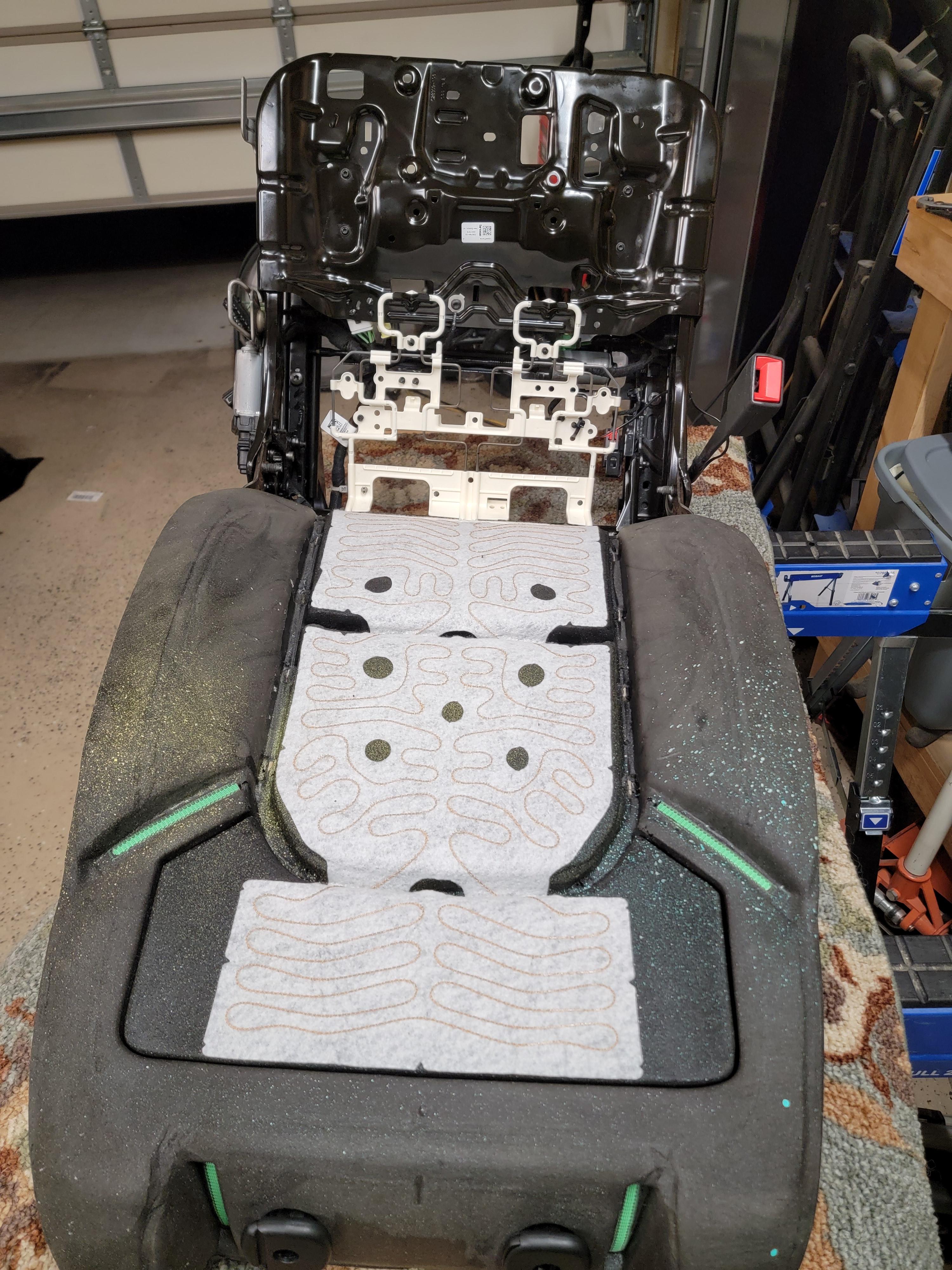

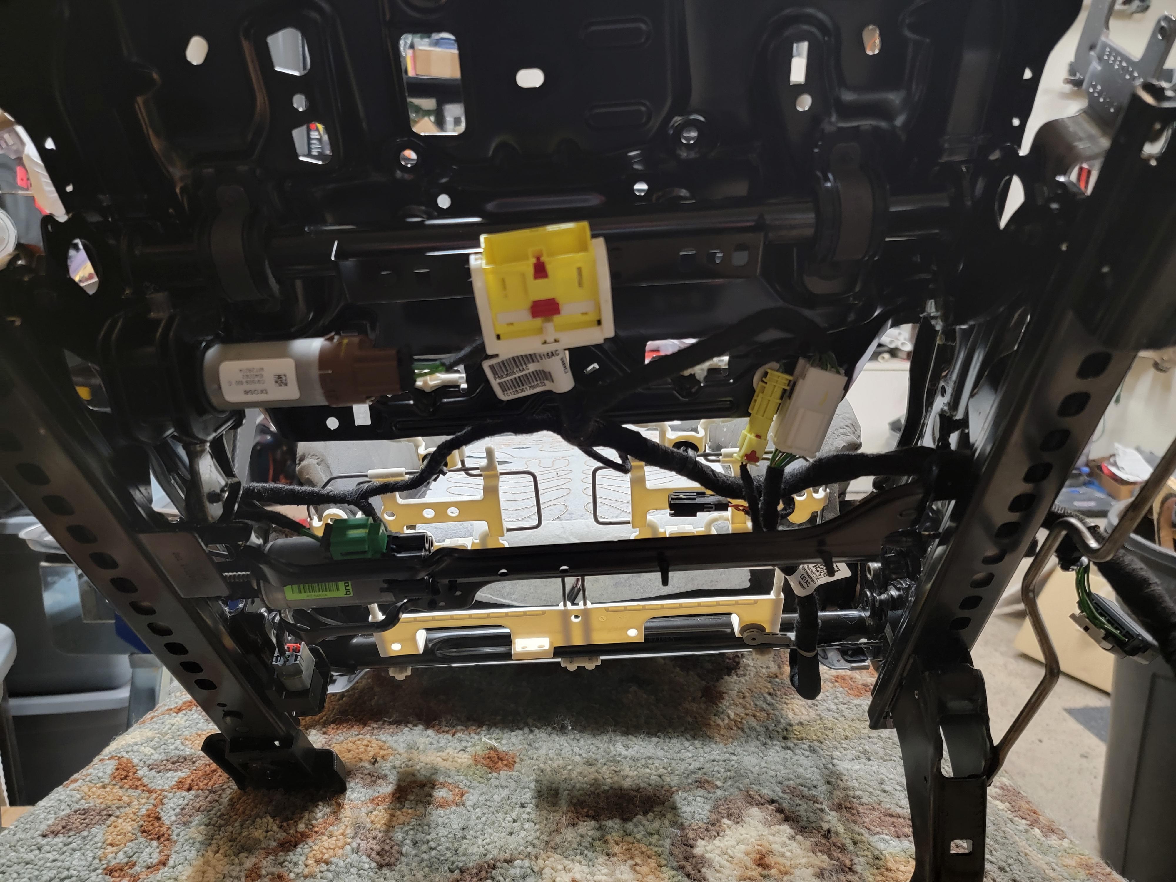

For the front seats, do the bottoms first and then leave them off until you finish the tops.
When you do the tops, fully take the airbags out. I did the first one without unplugging it and it was very difficult to get the hog rings on. I removed the airbag on second one and it was much easier.
I used a steamer to get the leather all loosened up/smoothed out. A couple weeks in the sun has also really helped. They look oem now.
