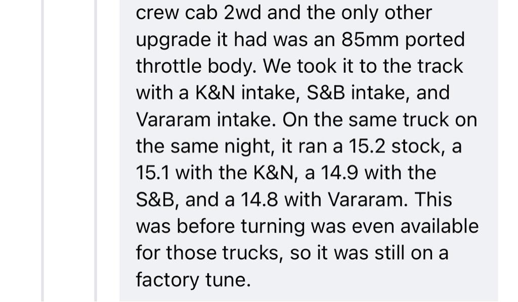

From moes performance.

Yep, that's what Vararam advertises. Would be very interested in a dyno to see if it indeed improved HP by 30.
