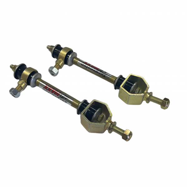

I purchased new sway bar endlinks from SuspensionMaxx for $100 (sold new by a user on this site that didn't need them), paid $264 for the Bilstein 5100s from Stage3Motorsports, and will be paying the ~$120 for the Mopar UCAs for my truck. All in, $484 for my Rebel level. I will need an alignment, but it's not costing $3900!!!!
I've read on here that many people aren't replacing the sway bar end links or the UCAs, so depending on your build, it could be much less.
