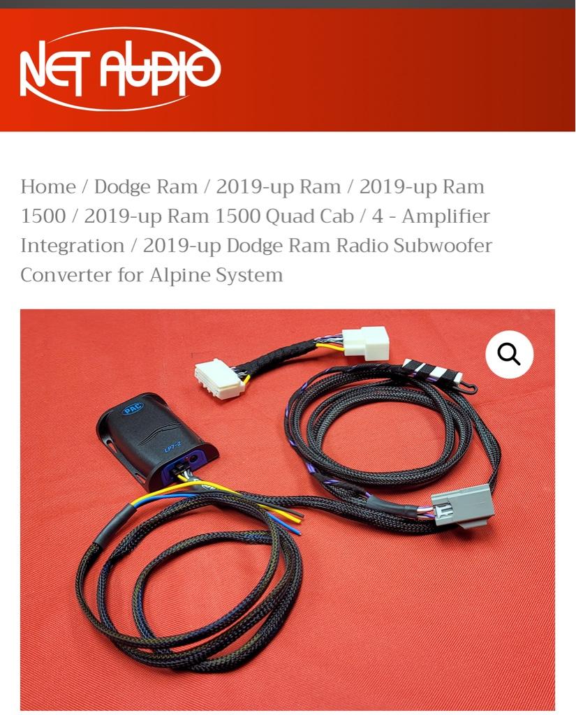

I just did this exact install for 2 - 12 pioneer subwoofers and a pioneer 2400 watt mono amp.
Use this adapter and you won’t have to cut a single wire.
All you’ll need to run is power from battery to back seat. And I ran my bass knob wire from dash to amp.
I left the alpine sub behind the rear passenger seat and just unplugged the gray plug.
Super simple install.

That works, they didn't have that when I did my upgrade the first time years ago.
