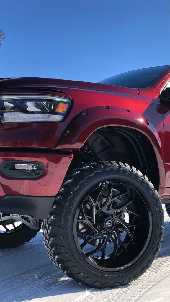

I gotta say, I just installed 37x12.5R22 -44 offset, and no amount of heat gun will get these things to fit without rubbing. I am on a 5 inch RC air lift + custom links giving me another 1-1.5".
I had to use custom Air Links so I could get the already 5" lift even higher, I'm in about Off-road 2 setting (with custom links). I had to trim the front plastic valance, I had to heat gun and zip tie the inner liner towards the back, and I had to trim the inside of the bushwhacker fenders but even then the tires were rubbing on the metal tab. I had to grind about 3/8"-1/2" off to get them to fit without rubbing. With all this said I have about 1/4" clearance on all sides, if I lower the air suspension at all I won't be able to make full radius turns.

Just got mine back. Thx to all in here as I love the way this turned out. 2019 1500 with no air ride and no off road package. 20x10 -18 fuel rebels and apparently new version of the ready lift 3.5 kit with 35x11.5 ridge grapplers. Haven’t done the trimming yet and incredibly minor rub in the wheel well plastic that the heat gun would fix. After there will be 100% no rub since the only rub now is full trim going off a lip on my driveway.
Truck looks great man !!! I want to do this same exact setup with off-road package and 2-in Mopar lift which gets me to 3" but I'm afraid I'll hit wheel wells or metal I can't make a final decision which offset to go with.
