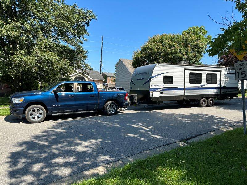

How big have you towed? w/Pics no tricks!
Participation Award
One way trip for my son.
Did not do a cat scale and overloaded on advertised tongue weight, 1,325 lbs, per manufacturer.
Tape measure, Timber Grove Air Bags at 14 lbs and Snugged/Compressed the Andersen Red Spring until I measured 1/4" from unloaded.
Travel Trailer was level, tested brakes on lot, off I went.
Two fingers steering at 55 and four at 65.
Lots of traffic for mid day on the highway, drove between 55 and 63.
Luckily the winds were 5to 10 mph, ever once and awhile you could feel the gust.
Operating Temperature normal/same as towing my 5k, 22ft long TT. 10mpg per lie o-meter.
Certainly would not transport or tow a 38ft camper but you do things for your kids.
