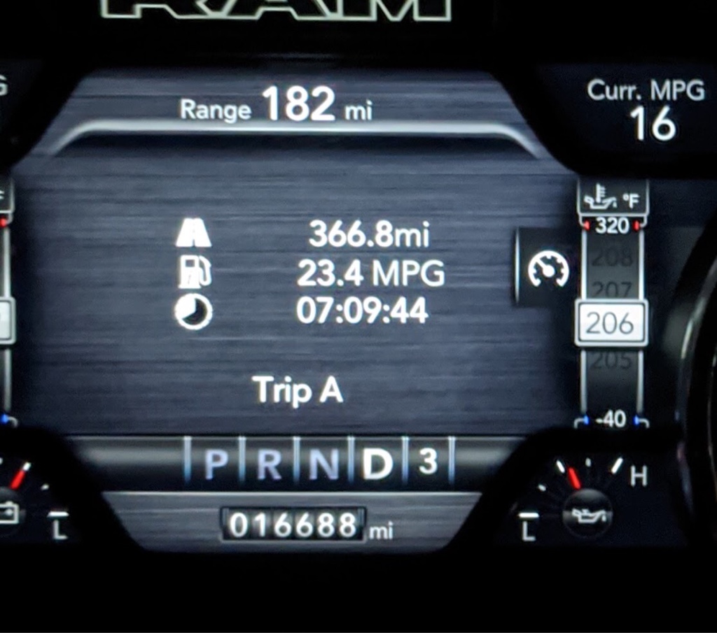

Just to see what it would do, I ran sub 70 MPH for a tank on moderately hilly terrain and got about 20 (hand calc).
Pic of an average trip readout attached
