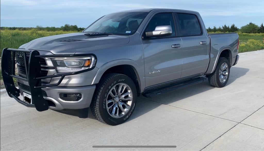

Just had the Nitto Ridge Grappler 285/60/r20s installed. Liking them so far. A slight rub against a piece of plastic wheel liner in the front, but only in reverse and when doing a full lock turn. Not a big deal. A few pics.
Looks good, what wheel offset do you have?

Must just be the angle, she sure looks level from where I’m standing . I have the ORG on a 20’ Laramie and will be throwing bigger tires on soon but still trying to nail down the best leveling kit option. Problem I have is the ranch hand grille guard adds weight and now gives me about a 3” difference from front to back. I will definitely have rubbing up front with the way it sits now. I may be maxing out the Bilsteins with some new UCA’s to get level.
Here’s a daytime pic you can see the rake
Thanks, and sorry that I just saw this. But I’ve not been on the forum for a while. I put the Grapplers on the stock Longhorn wheels, and it has not been leveled or lifted. It’s all stock. The tires rub a bit on a full lock turn, but nothing major.
285 65 20s on stockies. Was fine with no rubbing but was close. Used motofab 2.5 level and rough country 3 inch ucas to level since I have the ORP 1 inch lift from factory
How are you liking this setup since you've had it on for a few months? I have a similar truck and am looking to put these exact tires on, was planning on doing the bilsteins to get my level and rc ucas. Did you take your 4x4 off road decal off? I thought about it removing it but haven't commited yet.
