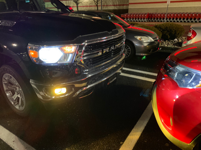

I've replaced all the bulbs on the front end with LED bulbs and I am pretty **** happy. Install took me longer than it should for a number of reasons, but the truck looks GREAT now.
For $220 (which is $10 more than the price of the Supernova V4 low beams alone) I was able to get LED low beams, high beams, fog lights and switchback turn signals from LASFIT.
I'll upload some pictures later when it gets darker.
