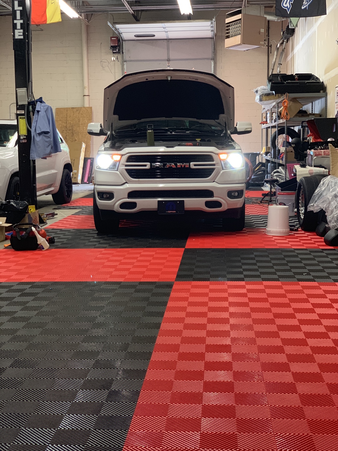

I actually installed a set on my buddies work truck today

So I figured I would start with the “easiest” part of the instal and do the high beams. Took air box out. Took the dust cover off and stock bulb. For some reason the high beam bulb from HR will not “turn” in to the socket. Pretty frustrating.
