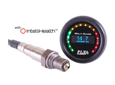

Did you have to add a AFR gauge for him to tune?

Did you mount the gauge somewhere? Any pics/info on that?
Here is the wide band gauge and unit that I used;
Are are few pics, not to happy with the gauge holder as this is a temporary spot to place it for now. It will be relocated later... Fabricating something for a better location. The gauge itself is extremely thin.
View attachment 42804View attachment 42805
Thanks man! I have to figure out a way to mount one a bit more incognito than that.
