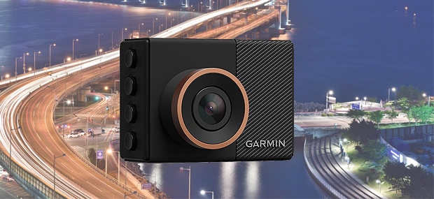

This is my install. Garmin 55. Hardwired. Size of this unit is 2.2”x1.2”x1.4”. Very un-intrusive. Excellent reviews. Voice activated recording.
Here’s a link to review in case anyone’s interested.

My Garmin 55 dash cam picks up Intersection Red light and speed cameras and shows them on the screen as you approach. I want to see that warning as I got nabbed twice.
I don’t watch my camera as it goes to black screen after a few seconds once the truck has started.
