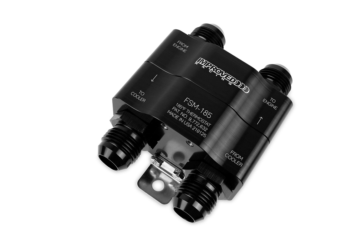

To solve the concern you have in regards to oil temps and a cooler you be best to run a thermostat controlled oil cooler such as this:
This would allow you to bypass the cooler when temps don't require it keeping oil temps hot enough to burn out contaminants yet allow the cooler to operate in extreme conditions.
That said, given the capabilities of synthetic oil, I see this as unnecessary as synthetic oil is perfectly capable of temps well past 400°
