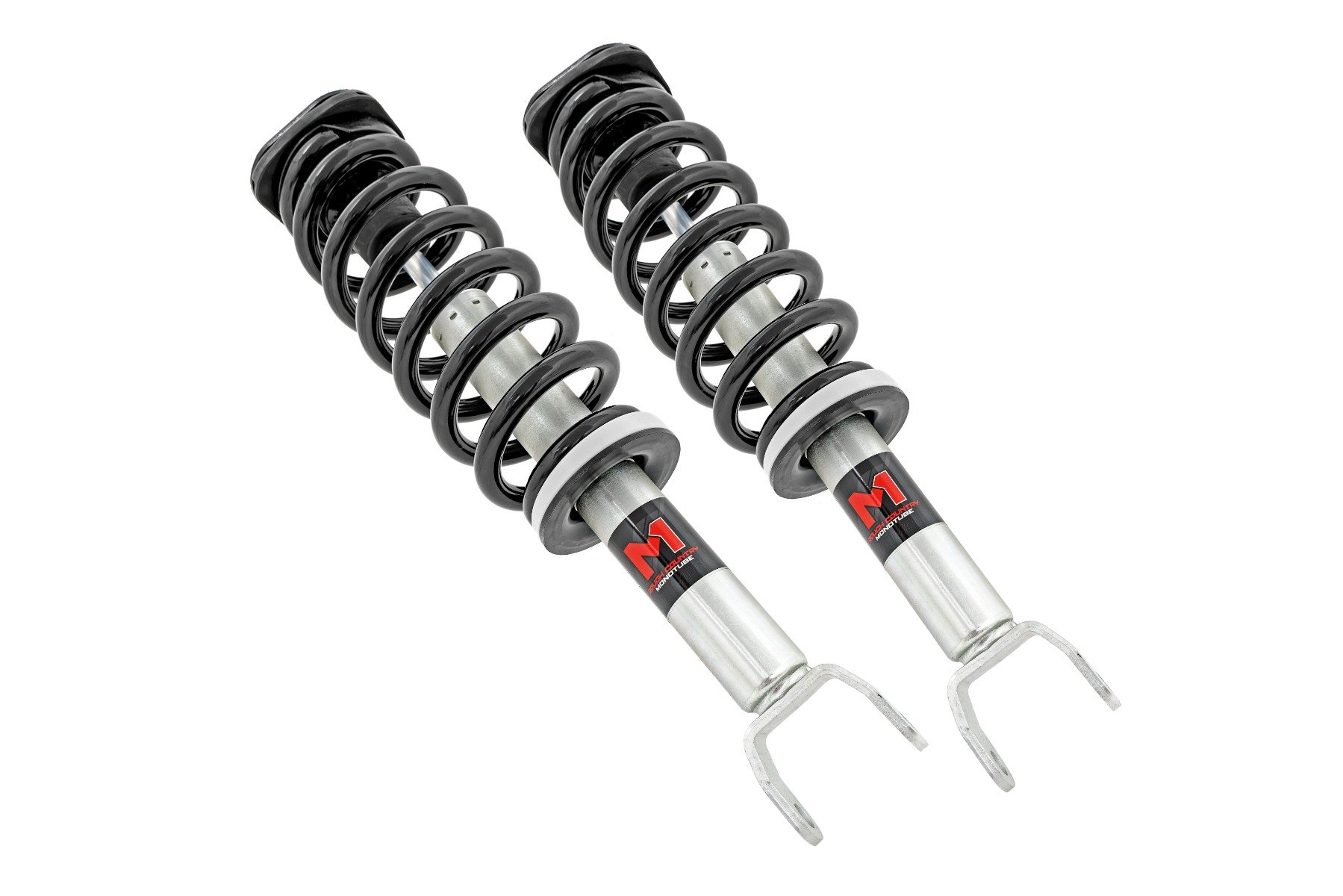

I'm looking to add a 2" leveling kit to the front of my 2021 Laramie (non-air-ride) and I've seen many different suggestions on how to do it.
I've read the spacers typically increase wear and reduce ride quality, so I'm going to upgrade the strut instead. I like the Rough Country M1s, has anyone installed them before? Also, is there anything else I should be upgrading to help keep the amount of wear down on the front suspension such as a new control arm?

I’m totally happy with my RC 2” struts. RC has improved in recent years compared to when they started. I’m on my second set of 2” struts, first set being on my 4th gen. Had zero issues with them at all. And the best part is that they are easily installed. Not having to reuse your factory spring and deal with the spring compressor is a plus. Easy 1 for 1 swap install.
Now full disclosure, I have zero experience with Bilstein 5100’s. I did just get a set of them for a price I couldn’t refuse (BNIB), but only because they came with a package deal. I may or may not install them. I am curious as to how different they are compared to RC. At least then I’ll have first hand experience of both and can give a true experience review.

I went with RC for the ease of install and good prior 4th gen 2” strut experience. I ran RC products over the years on previous Jeep TJ, YJ and XJ. The new RC products are much better quality IMO. Plus they have great customer service and a 3 year warranty. They firmed up the front suspension a bit for the better. But not too stiff by any means. And that’s with LT tires set at 40PSI. It was worth a shot and I’m very happy so far. I have about 7k miles on them so far and am still very pleased. IMG_0164.jpeg
