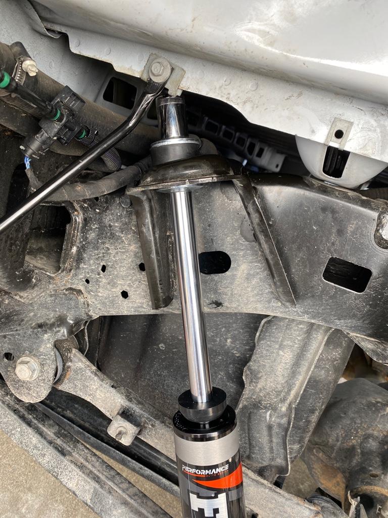

I had the same problem with the rears but used a couple of nickel sized 1/8" thick rubber washers, one on each side of rod and used these vice grips "home depot" which allowed me to crank them down enough.
2020 Ram Rebel 4x4
Did you guys lift the boot up and use the vices on the shaft?
Thanks for the help! I finally got the stubborn side off and the new shock in. How did you torque down on the upper shock nut? Its impossible to get a wrench in there!
Its been a while, but I think I used whatever torx (I can't recall the size or if it was a torx) bit I needed in the top of the shaft and then a combination wrench to get it to what felt tight enough. I used a torque wrench on a different bolt so I "knew what it felt like" and used that as a mental gauge for tightening. YMMV, I'm not a mechanic.

Lol thats basically what i did. I didnt want to make it too tight because it was really compressing the rubber under the washer.

Just about to install my set of FOX 2.5 Performance Elite front and rear (19 Rebel). Is there really no way you can flip the rears for easier access to the dsc? Is it a clearance issue? Was reading that the resovior has an IFP so should be no issues with regard to performance. I also noticed that there doesn't appear to be any roost guards available for the 2.5s so is a little riskier to have the shafts so openly exposed...could get some made though 🤔

Its not possible to flip them because of the mounts are different on the top and bottom. In theory you could get custom connectors, but YMMV. You are correct that adjusting this is a pain in the ***. I have mine set for my preferred off road settings and I just deal with it. I haven't had issues with the shaft being exposed. However, I imagine you could solve this with a small piece of flexible plastic and a hose clamp just to keep most of the debris off coming from the front of the truck.

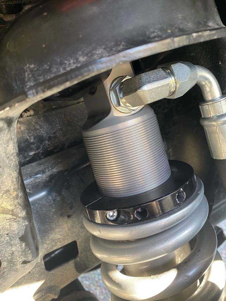

Hey guys, just got the front leveled and was wondering if anyone has a picture of their thread count? It seems like i needed a lot of thread to get the front level.
