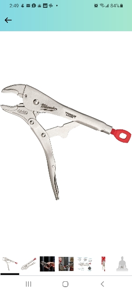

Did anyone find a good way of removing the top nut on the rear shocks? Turning the nut just spins the shaft.
I would love to hear from a more qualified person, but I got mine off by wrapping an old bike inner tube around the shaft twice and then using a pair of vice grips. The tube provided grip and protection from the vice grips. Worked like a charm and the shaft had no damage.
Damn, ive tried that. Still spinning. Was your lower bolt in when you did this?
The bolt was in but not tightened. If you don’t care about salvaging the old shocks, Vice grips without the tube will definitely work
I had the same problem with the rears but used a couple of nickel sized 1/8" thick rubber washers, one on each side of rod and used these vice grips "home depot" which allowed me to crank them down enough.
