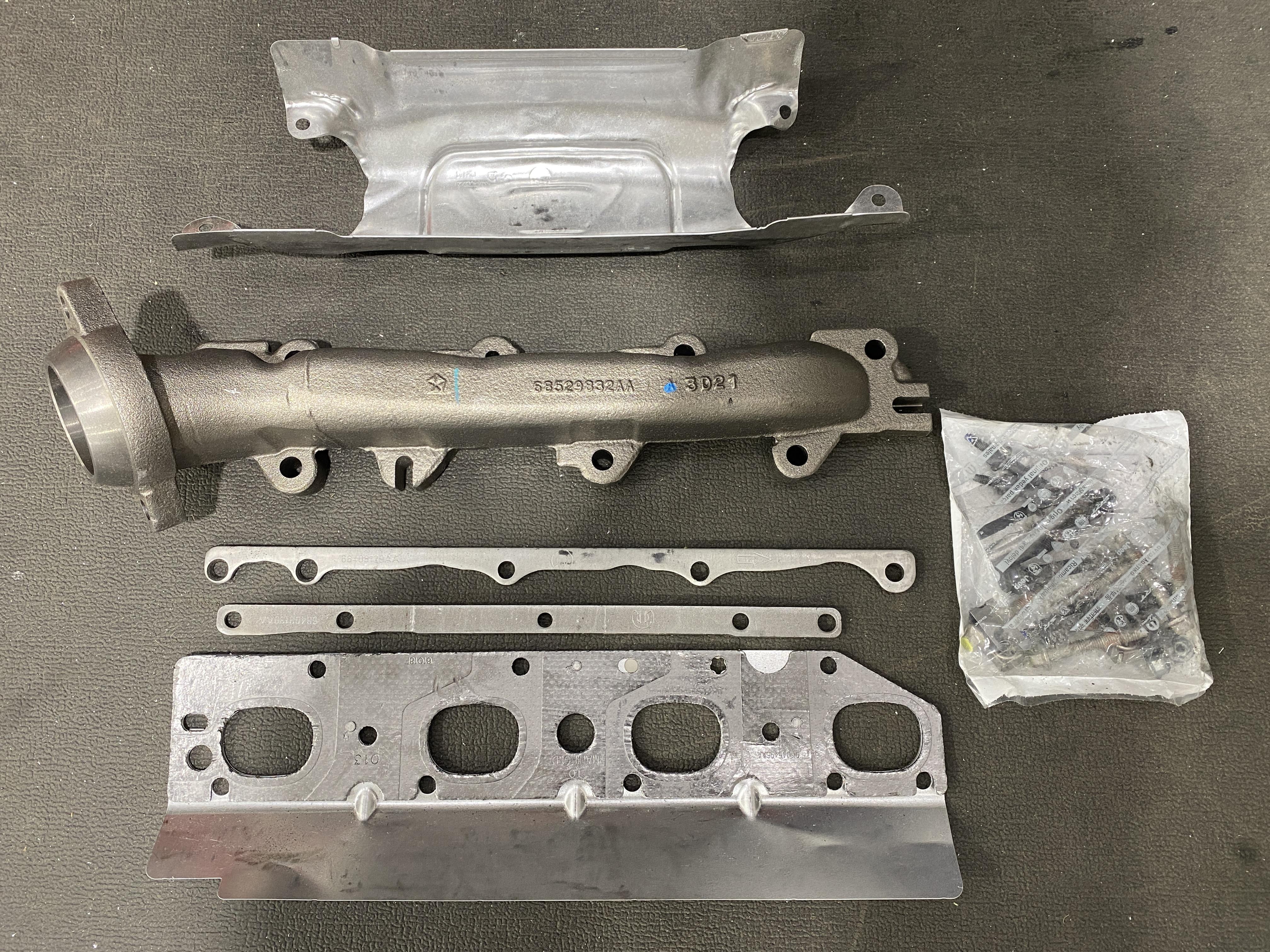

Manifold kits arrived last night.
This is the passenger side kit that was $65.67.
FYI, the box says made in Korea and is dated 2023/08/29.
