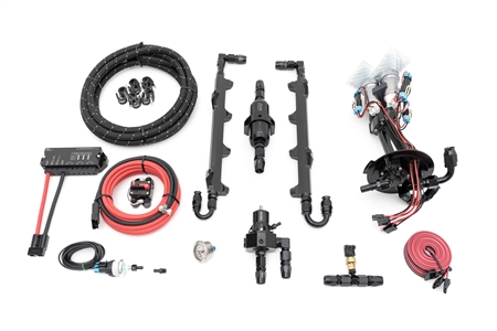

A fore double starts at $2300 for a TRX, if you go over 6PSI of boost, you're gonna need to buy a fuel system. Fueling is absolutely critical on boosted applications. Granted, a fore is likely over kill for what you want to do but you can see how easily you can end up with a thin wallet.
I just bought ID 1000's injectors for my car, that was $1100 alone, I still need to decide if Im going to chase a few more HP and run E85 which will require more fuel pump and I already have a boost a pump
I can tell you this from experience, I'm on my 2nd $16K engine, I have 10K in the trans and diff, $2k in a McLeod RXT easily another $10k in supporting parts like $900 lifters and I could go on. Point is this started with wanting 100 more HP. I have now almost doubled the stock HP that the car came with and nothing unmodified lasted behind that power. I used to be in the "you spent how much on that? I can gap you with $1500 in mods on a 10k car and still not have spent half what you did" crowd.
F all that, now I understand and appreciate the value of factory engineered high horsepower that you can live with everyday and not drive next to bridge embankments or concrete barriers/ Jersey Barriers wondering what that new sound is or if its always been there. I see the value in a TRX/Redeye/C8Z06 or any other high horsepower factory car vs building something that if when it breaks, you're on the hook for. I love the mindset of all I have to do is put fuel in it and change the oil, no worries.
You don't need a whole new fuel system, justarger injectors and a proper tune. As long as the fuel pump can keep up with demand. At some point you will need to uograde the fuel pump, but you can do just the pump for a fraction the cost of a complete fuel system. You'd have to be north of 1000hp before you need to think About a complete fuel system replacement. I know guys with Scat Pack Challengers pushing 1000hp with just larger injectors, a higher volume fuel pump, and tune, plus the other supporting mods. But stock fuel lines, and fuel rails. And the fuel pump was just a replacement in tank pump
Believe I said that.
BTW, to me, a new pump and new injectors is a new fuel system, you're not replacing the lines unless you go to a return style system.
A walbro is a fraction of the cost. A good system like a fire double or triple is far more reliable and better performing. In not opening the tank to swap in a damn Walbro or a DeatschWerks and I'm not running a fuel system that's operating at 85-90%.
You can do it right once or you can make it work 3 or 4 times then do it right
