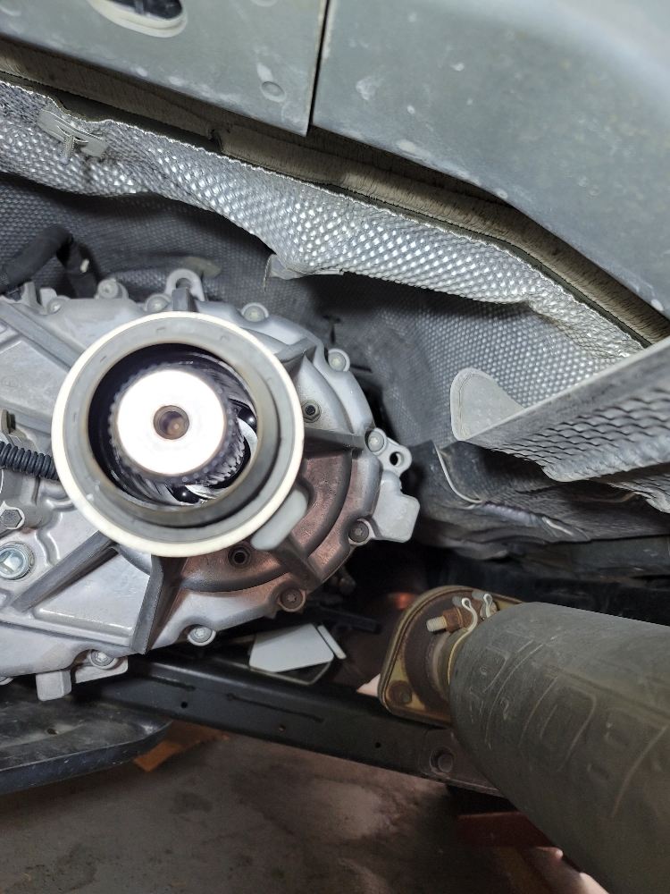

They need to remove the drive shaft, take one of the clamps off the dust cover closest to the rear. Slide the rear shaft out apply grease in the weird long extended slip yoke. Mine is smooth as butter now. I posted a pic earlier of the drive shaft and what the dust cover sleeve looks like.
If you could provide an update in 1K miles that would be awesome. Hope yours stays put!I've had a "release" in mine for almost three years. Clearly not as bad as some here as it wasn't a clunk, but since I have ETorque and the extra sensation of engine braking it's been hard to nail down. Had it in the dealer once only to be told "they all do that." Well I've now twice had loaners (non-ETorque) that were smooth as butter so clearly they don't all do that. I dove in and dropped my driveshaft today.
I've got the aluminum one piece so it only took about an hour. When I pulled it off, it had black grease that looked like it covered everything, but very thinly. So I cleaned it all off, and generously relubed (not too much) with moly CV lube. Took it for a test drive and what do you know? It's now the luxury car of the year! I wish I'd done this three years ago. It is so much more refined now especially after a harder deceleration. It just accelerates smoothly - like those loaners.
Thanks to all who posted how to's on this! I definitely recommend it.

Much appreciated.No, didn't take any pics, but this site shows almost exactly the same thing: https://www.dieselplace.com/threads/lube-splines-in-rear-drive-shaft-slip-yoke-to-fix-clunk.51652/
The last pic shows the splined output shaft of the transmission/transfer case and ours looks the same. It's basically like a very deep gear with teeth on the outside. What I lubed was the matching inside splines (teeth) of the coupler that is attached to the driveshaft.

Bone dry, yikes.![]()
There really wasn't anything in the other end either. I hosed it out with cleaner and the only way I could tell that there was any sort of lubrication was the water was slightly black. Otherwise it looked just like the end pictured. The clunking between P, D and R is gone. I definitely recommend doing this if you're transmission is clunky. It just feels tighter. I used Lucas Red N Tacky because I was waiting on my shipment of Redline CV2 to come in, and I just wanted something in there. I'm going to see how this holds and maybe clean it out again at some point to put the Redline in now that I know what I'm doingWow, not even a hint of black grease on either end? You should feel a noticeable improvement!
