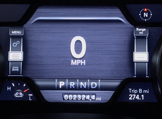

I'm sure your already aware, but for those that aren't - there is a setting so you can have the gear show up on the display without the use of the +/- buttons. I can tell when it's in MDS by the exhaust note and engine sound. Not sure if the wife would notice it or not though - it is pretty faint.
I'm not aware of this, no. How do I get the current gear to show up, without using the +/- buttons? I looked everywhere in my dash options, as well as my uconnect settings, can't seem to find it.
I usually can't tell other than the eco light, unless the stereo is off and the back window is open. It to me sounds like an off pitch uneven rumble, not as loud, slow or pronounced as an Alcohol fueled dragster....but kinda like the timing is ratcheted back....
If it exists, it should be in the cluster screen settings.
It's a setting in UConnect. I'll try to find it and post it.
I've enabled it several months ago so I can't remember how to do it off the top of my head.

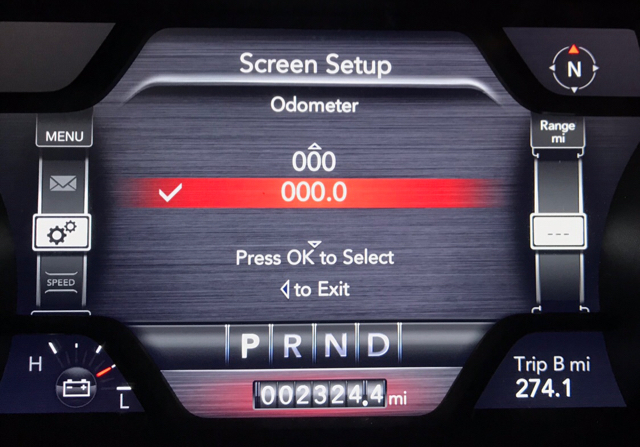

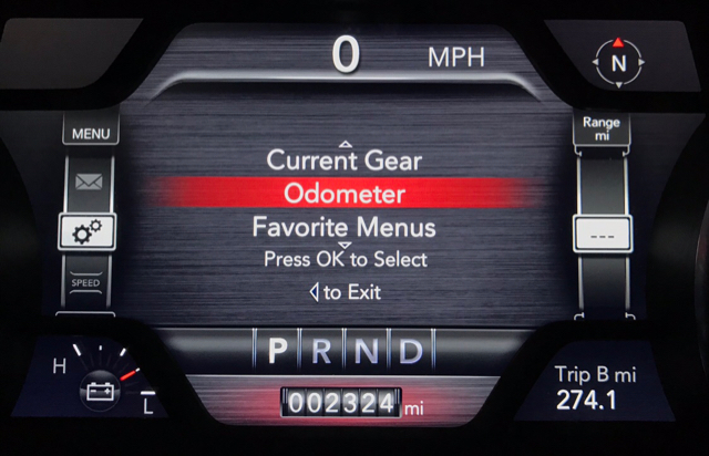

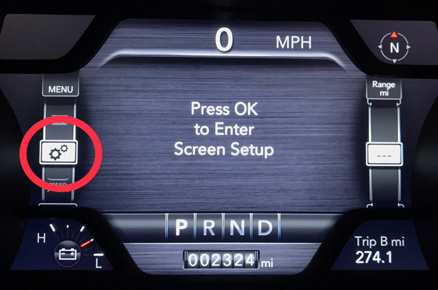

Go into Instrument Cluster Screen Setup to set odometer tenths (pics show premium instrument cluster).
- Press Engine Start button to ACC.
-Press left steering wheel up/down buttons and press The Screen Setup feature can only be used while the vehicle is in PARK.
- Press the steering wheel left Up or Down arrow button to Screen Setup and press OK.
- Navigate to Odometer and press OK.
- Select to display tenths and press OK.
You wouldn't happen to know how to get the current gear to always stay visible, without having to use the +/- buttons?
