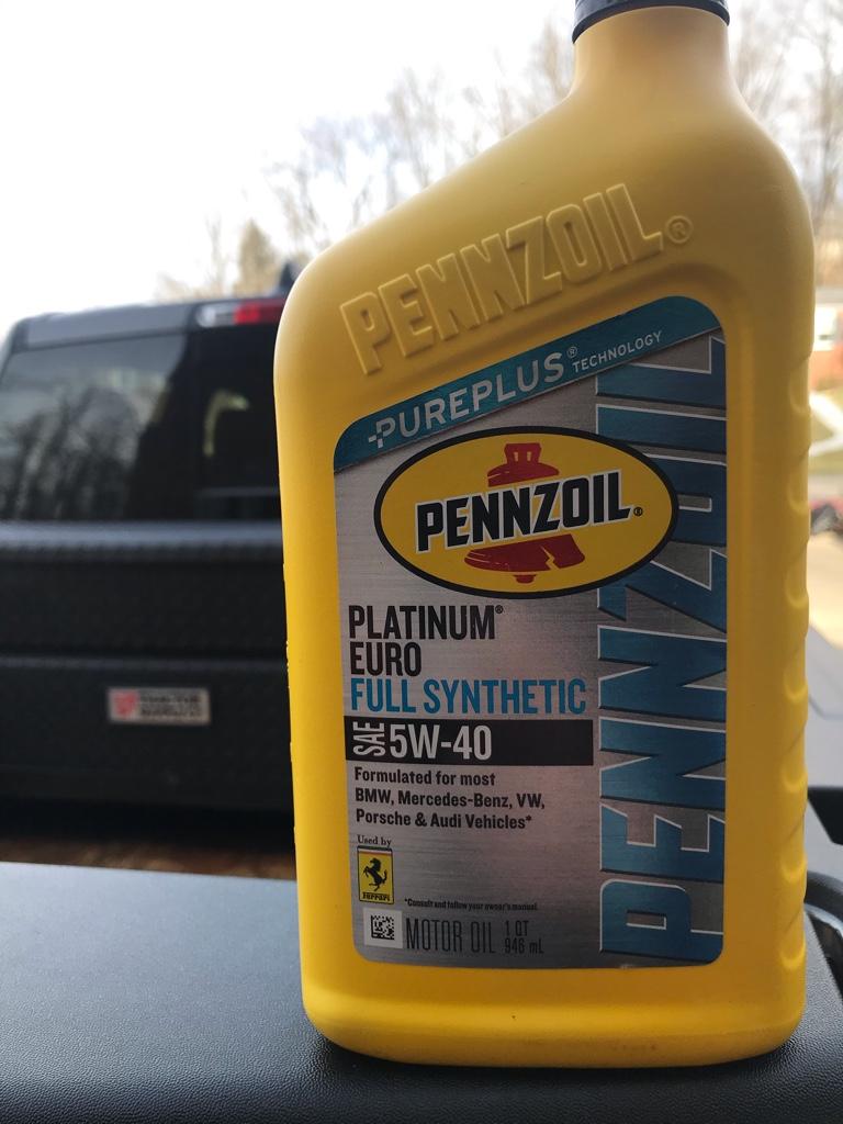

I was able to find some at Advanced Auto Parts, it’s quarts only and $9.99 per.
It works out for when I buy a Ferrari, I will know where to get the oil.
I bought this about 3 weeks ago from amazon.
