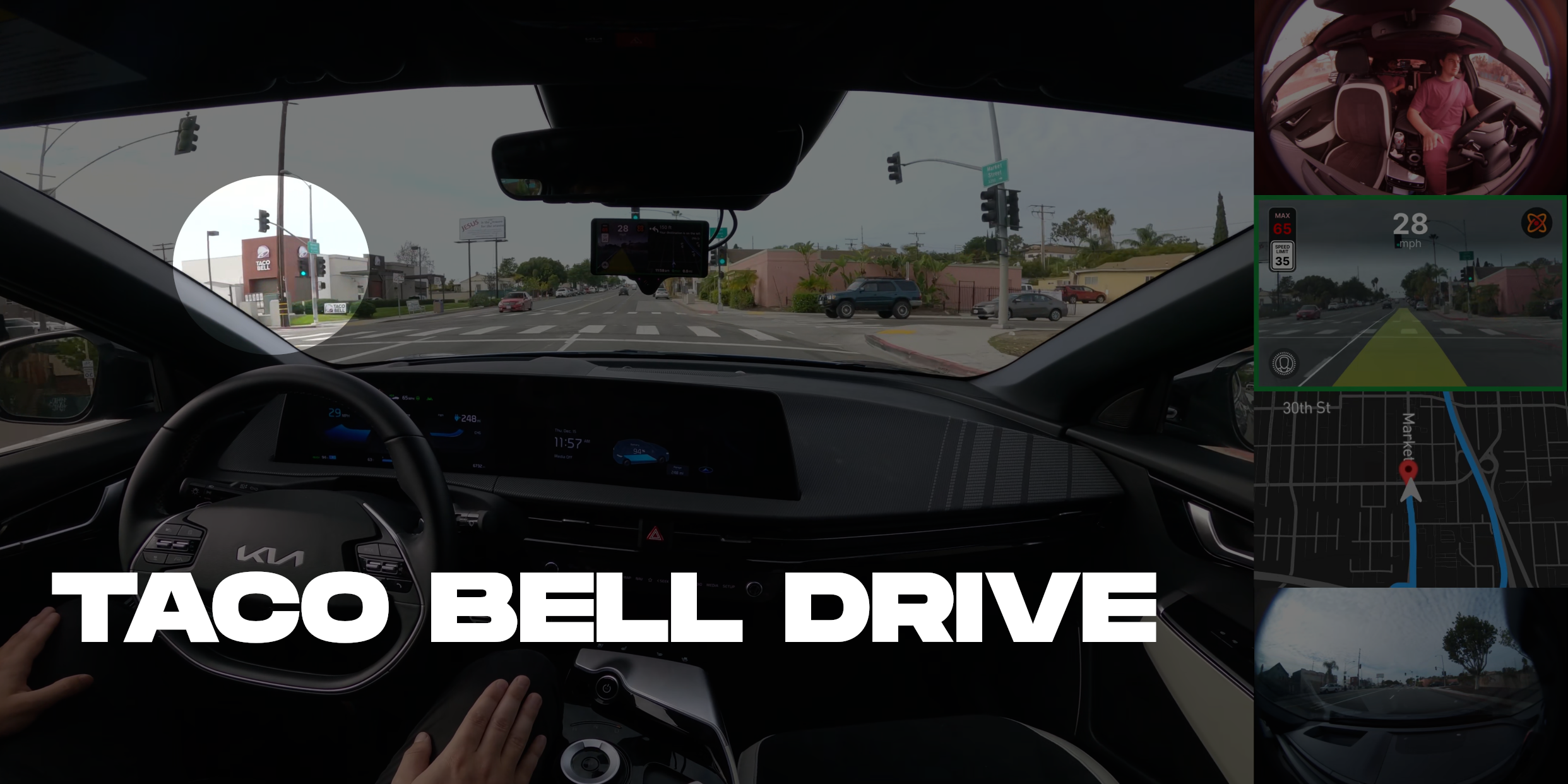

I just saw a video of them "driving to Taco Bell" but I had to watch the video at a reduced speed to see what was going on because they speed it up (most likely so people wouldn't see the flaws?)
I saw the car drive over marked lanes, almost hit an SUV on the highway because the Comma AI didn't keep the car in it's own lane, and almost completely stop at a greenlight long enough that people went around it.

That is them messing with and tweaking true end to end navigation. You put an address in and it goes. Longitudinal control (gas and brake) doesn’t work on the RAMs yet, only steering. Your built in ACC does the gas/brake, and comma steers. It does pretty incredible. That video isn’t really a relevant experience to what the current state is for RAM. Mine drove me from Nashville, TN to Lexington, KY a week ago with almost no needed interaction. (Only had to take over for exits, etc) Dead center of the lane all the way. Can’t state enough how awesome it is on a long drive.

The video was released by the manufacturer, I wasn't watching a thrid party video...

Does anyone have any footage from their own trucks they can share since it seems that the video they posted was a bad example (at least for Rams)
