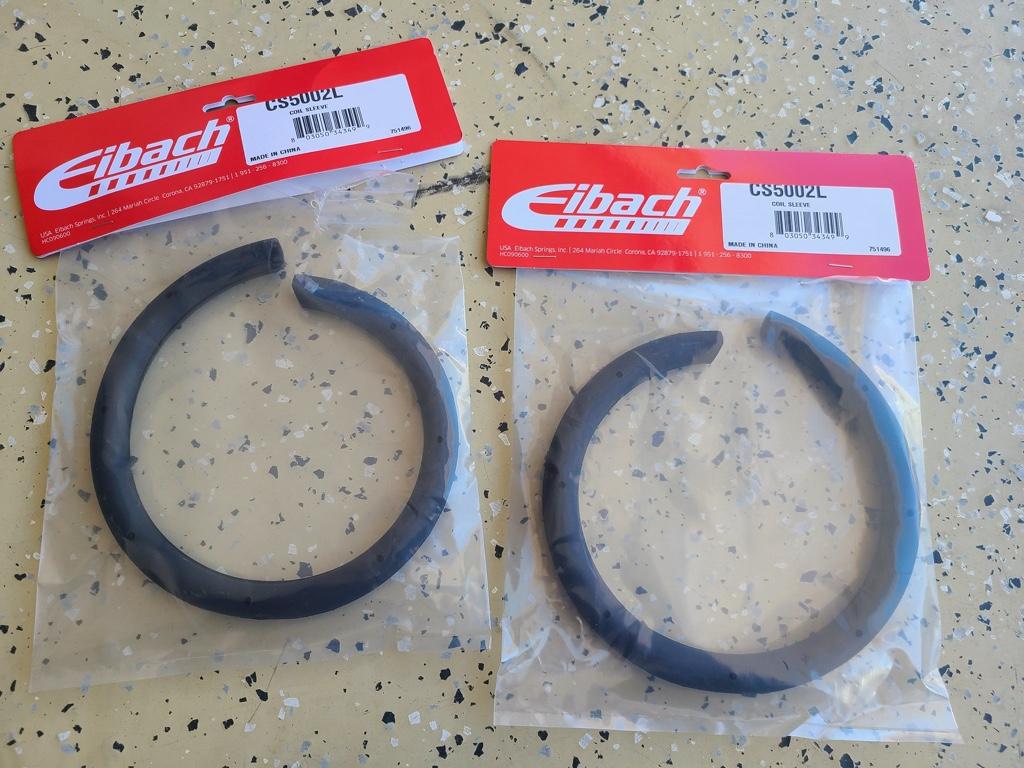

Well if you ever want to add them to your truck “ram1500rsm” told me that he solved the issue on the Icons and his Claytons with this sleeve. CS5002L
How many of the sleeves did you buy?
Too many, six. Still waiting for them since I had to send them to Miami and them have them shipped to Puerto Rico.
Ahh ok yeah I wasn’t sure how many I needed. I was thinking 1 per side? Maybe 2? Idk

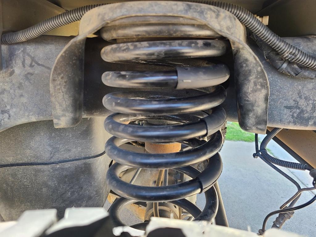

So ram1500rsm showed me a foto of his set up, ill send it to you, and a total of 5 coils were in contact so 3 on each side will solve it or 1 cut in three pieces.
Ok thank you!
