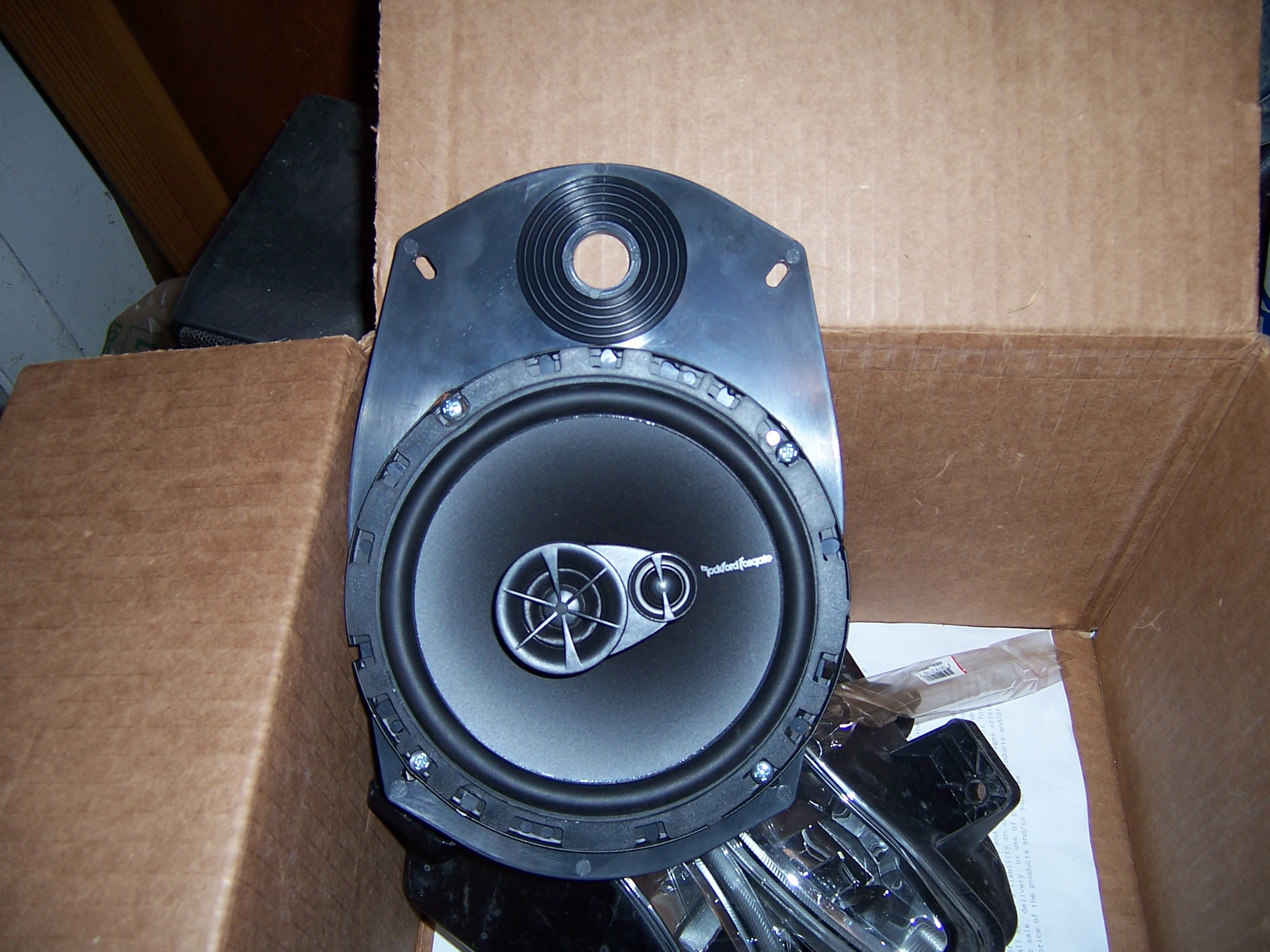

last spring i did the front dash,last weekend i did the rears.i use 6.5.and the metra speaker clips
