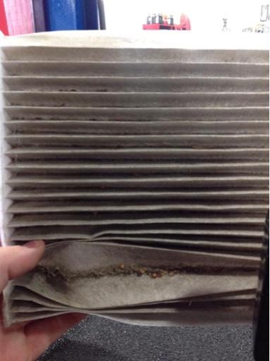

Swapped mine out today at almost 10k, was expecting it to be bad from pix here.. but it wasn't that bad... curious if dealer swapped it when they did my oil and tire rotation at 6k miles.
Glove box removal was super easy took 5 min all together. Just opened glove box and pushed bottom hinges out wth my finger then pushed in the top for it to drop.. left the cable attached... took longer putting it back than getting it out.
Got my 2nd service today and the cabin air filter was filthy... Again. 13K miles, so 8K on this cabin filter.
Seems like the cabin air filters are effective, but they need to be changed often in dusty environments.
Engine air cleaner stays cleaner.
Hinges released WAY easier the second time than first for me... I don't know if its because I knew the angle to use the second time or the plastic was more pliable from having previously been removed... first time was frustrating - second time was a breeze.

Inspired by everyone ITT, I ordered the Fram "Fresh Breeze Cabin Air Filter with Arm & Hammer Baking Soda, CF11671" from Amazon, which arrived today. I think I had the glove box door, cabin filter cover removed, and the new filter installed before the Amazon delivery driver left the cul-de-sac. There was some light debris trapped in the cabin filter which spilled into the floorboard area, so I took the liberty of vacuuming the interior of the truck while I was at it or I may have had the whole job done in under 2 minutes.
Watch the YouTube "how to" videos on how to remove the glove box door (yank on the side closest to the center console and drop it on the floor), pop the two tabs on the cabin filter cover and - as the British would say - "Bob's your uncle". It's that easy.

I replaced my filter last week at 16,000 miles. lt was dirty but no terribly bad, so I think 15-20K will work for change intervals for me.
Changed my filter again today at 34K, had to come on here to see when I did it last I knew it had been a while. So 18K and 18 months, much dirtier this time around.
