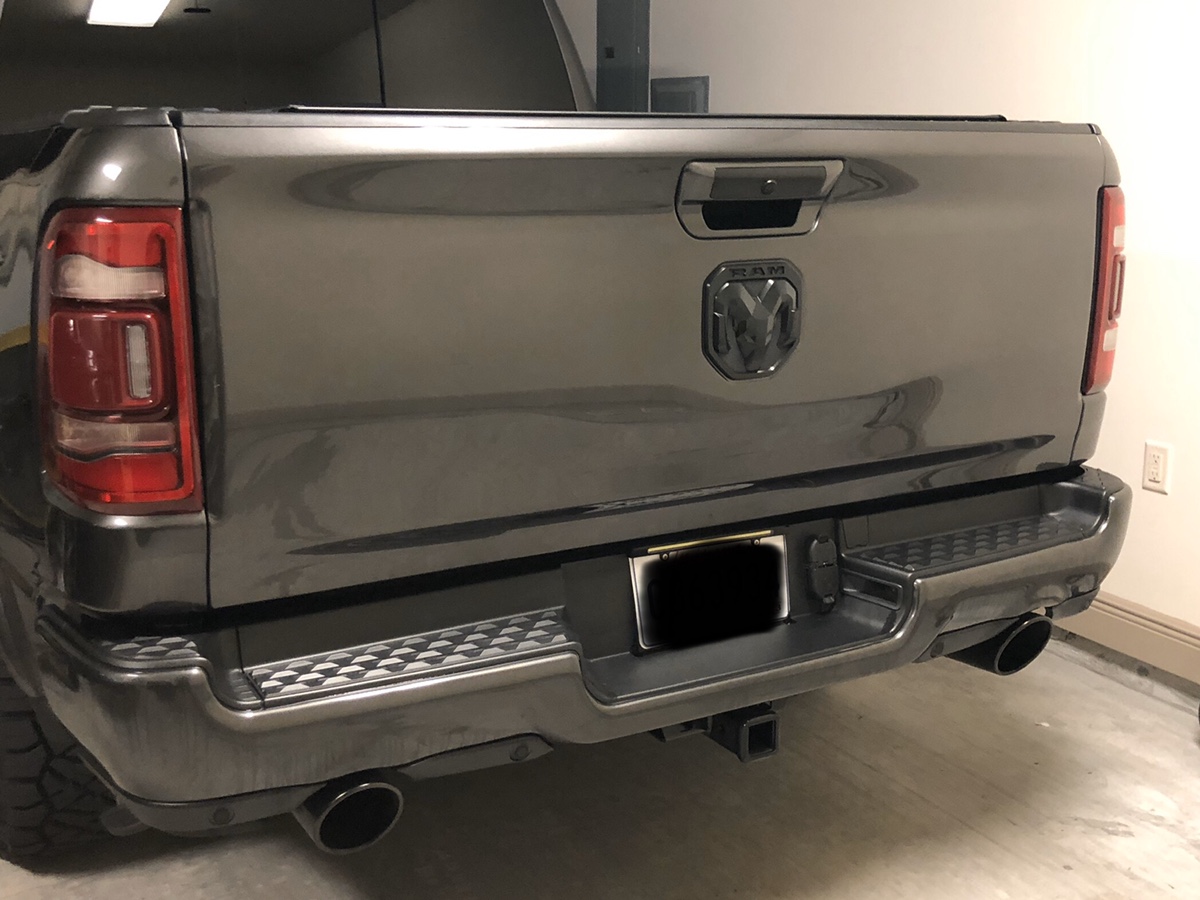

There is a trick to improve the Magnaflow cat back alignment to bumper! If you take a big pair of slip joint (sometimes called water pump) pliers and force rubber block that hanger rod goes through in direction exhaust tip needs to move (basically get block to slide on rod) , then while holding block at the desired spot , add a medium/small screw hose clamp to rod and tighten to hold block at that position. This idea came from another member and worked perfect for me. Hope it helps. Here are some pics I still have. :cool:IMG_3012.jpgIMG_3013.jpg
