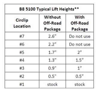

Good to know, thanks. I picked up some Toyo at 3’s in 275/60/20 and also front and rear ORG springs to go with the Bilstein’s. I may just use the front ORG springs on setting 4 and use a motofab 1.5” rear spacer instead of the ORG rear springs to get some more rake.
Anyone think there would be a big difference in ride quality between ORG front springs on setting 4 or non ORG springs on setting 6? Any thoughts if one would ride smoother? I have an appointment set up just can decide what I want to do.
Thanks for any opinions.
Can’t go 6.. 5 max.
Sorry I meant setting 4 using the ORP springs, or going with setting 6 using my factory springs which are non ORP springs. I do have the ORP springs front and rear in my garage.
The non-ORP spring on 6 will net 2.2" of lift and the ORP spring on 4 is 1.5"+1"(from the ORP)=2.5" I am not sure if the spring rates are the same for each spring. In each case you are compressing the spring to one level below MAX. Now, what I do know is I did the ORP spring set on 4 + a 1/2" top hate spacer and the truck rides good to me. Is a little stiffer than stock, but it still rides very good. In either case it will ride stiffer.
