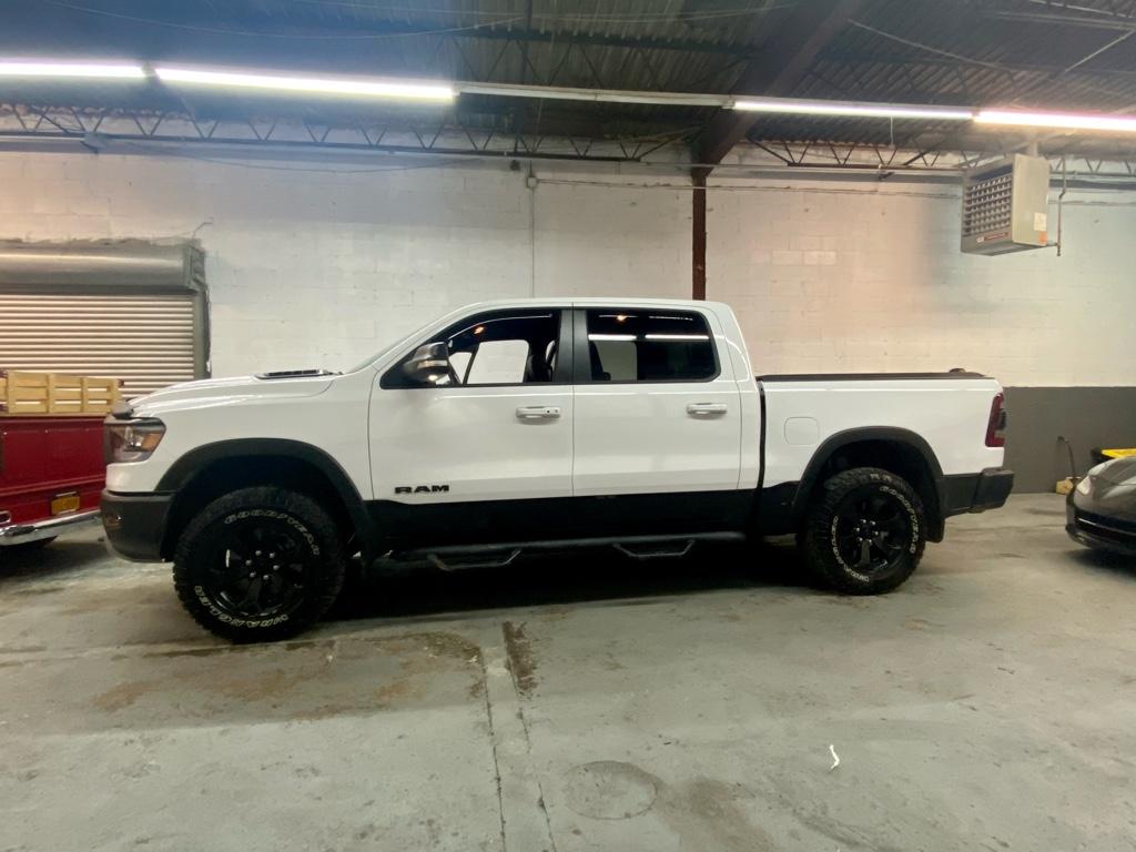

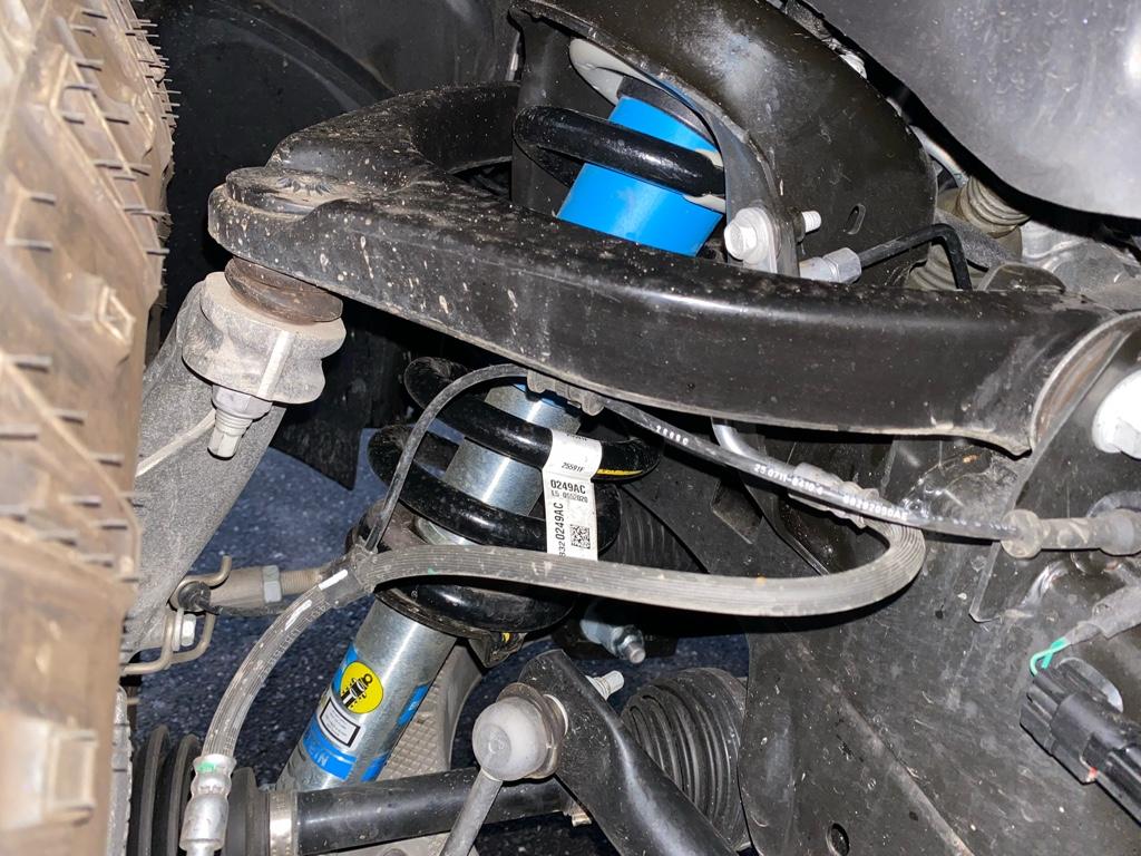

Thought I would give an update on my set up. I lifted the rear 2” using icon rear springs and a 1/2 spacer from McBay performance. I intended to lift the front 3 1/2” using the Bilstein’s at #5 (1.7”) and a 2” (actual size was 1 3/4”) top hat from Tuff Country. This setting actually lifted the front end 4 1/4 from its stock height and left it nose high. I dropped it down to setting #3 which leveled the truck. I used a level on the frame. The front fender opening does measure higher than the rear at level so if you are using the fender openings as your gauge then it’s probably not level if they measure equal from the ground. After tearing the front end apart twice in pretty happy with the turn out.

I had the Bilstein 5100's installed today all around. For the front on setting #5. On the back I added a 1 inch motofab spacer. Pics tomorrow as it got too dark when I got home. I did 275 65 20 rubber at the same time. Lifts and rubber, I gained 2.7 inches in the front and 2 inches at the back. Went from ~2 1/4 inches of rake to ~1 1/2 inches of rake. Came out as planned.

I had the Bilstein 5100's installed yesterday all around. For the front on setting #5. On the back I added a 1 inch motofab spacer. I did 275 65 20 AT rubber at the same time. Lifts and rubber, I gained 2.7 inches in the front and 2 inches at the back. Went from ~2 1/4 inches of rake to ~1 1/2 inches of rake. Came out as planned. I just wanted a slight lift and to leave a slight rake. Oh, I have 200 lbs of tires and old shocks in the bed in the after pic.
