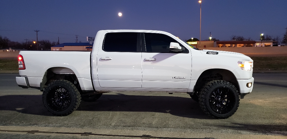

I installed mine this weekend at the 6th position and went with Nitto ridge grapplers 295/70 18's.
That's the look I'm looking for, nice! How much clearance do you have with the 295/70/18s? Would I be able to not run at setting 5? Thanks!
Thanks! im 99.8 percent sure you will be just fine if you go with setting 5. I dont rub at all lock to lock
