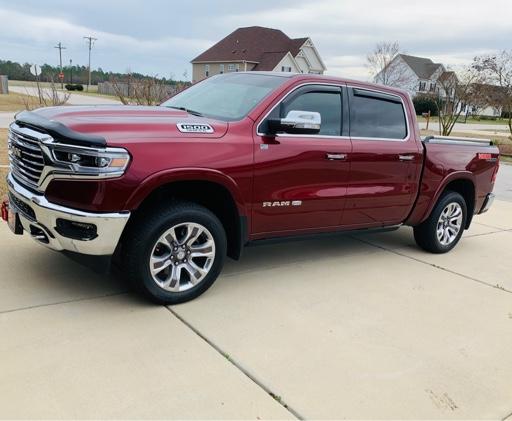

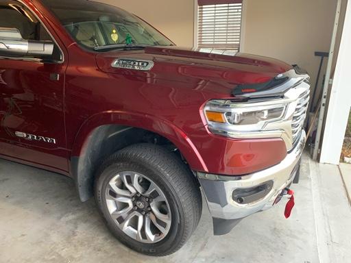

I have the north edition which has the 1 inch factory lift. I did the bills set at the 5th setting which is max on my set up along with the mopar lift uppers. I still have about half inch of rake. Still on stock tire but going to 275 65r 20 next week. First pic is stock 2nd with bills
Looks great, exactly what I have in mind! Thanks for sharing the pics. The 275/65r20s will fill in those wells nicely.
