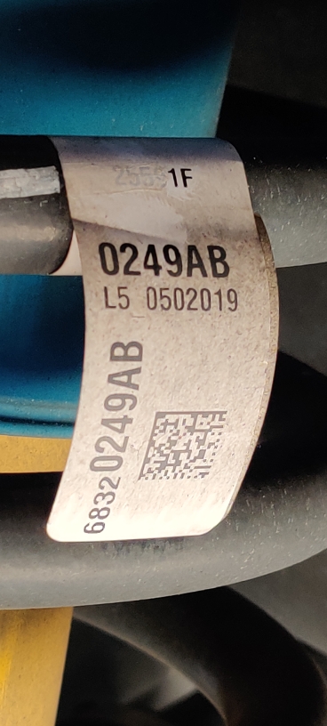

Yeah not sure about springs but we know the struts are bilsteins so they are probably aware of the strut / spring combo. Perhaps the ORP coil spring part#'s are on the site, below are pics of the part# tags on my rebel.
