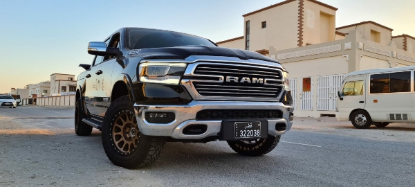

You guys think 18×9 -13 offset fuel vapors on a stock 2020 rebel would rub?
It would be great to see what oversize tires people are putting on the new 2019s with stock or off-road suspension. I am guessing 33s will fit without issue (275/60R20), particularly with the off-road package, but it would be great to know for sure, and to see if anyone has gone bigger.
35x12.50 work on 18" wheels with +12 or less offset and a 2" leveling kit.
MVIMG_20200608_181906.jpgIMG_20200102_071015.jpgMVIMG_20200608_181906.jpgIMG_20200102_071015.jpgIMG_20200102_071005.jpg
It will rub with stock suspension. With a level you should be fine. I’m running 20x10 -25 with no issues.
Do you have pictures? I want a 2" strut spacer level with 305/55r20 with 20x10 -18 and would love to have it not rub! Pictures of angles and stance and all that goods so I can decide! 90% highway miles here.
Cv angles are nearly flat. Rides good. I’ve got a Readylift top hat spacer and control arms. It didn’t change the ride at all. The increased stiffness only came after I installed the new tires.
I do have a very slight rub in the front of the front wheel wells. When in full lock over bumps or in reverse it runs the plastic liner. Easily fixed. Just need to heat the liner up and push it out a hair.

Awesome! Thanks for the pictures. Maybe the -18 will make it not rub then. If it's just pushing the front of the inner fender back a bit that's not too bad. I want to avoid cutting at all cost!
-18 might buy you just enough to clear it. Each truck is slightly different as well. Others have not rubbed with the same setup. Either way, all that would be required is heating up the plastic liner with a heat gun and pushing it out. No cutting required.
