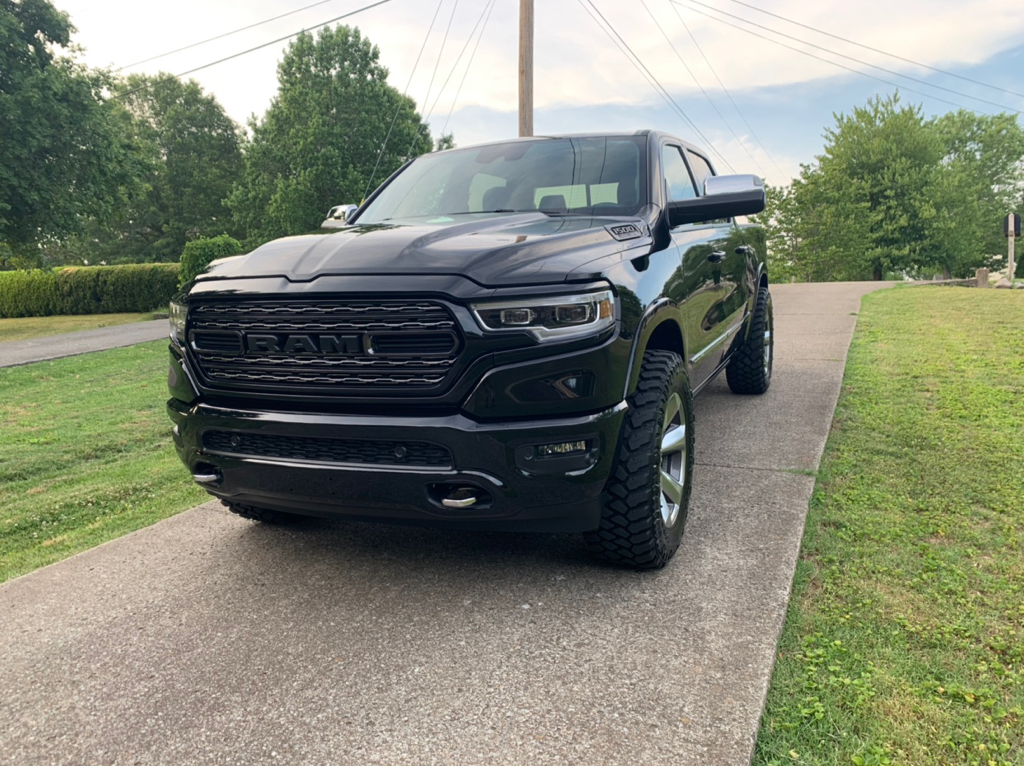

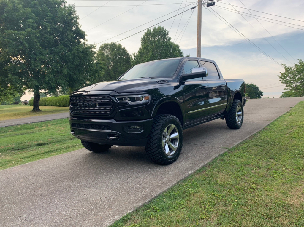

I’m not certain, but with the 2” spacers, I think 35-12.50 will rub with only having links.
I have 35-12.50-20’s and could not add my 2” spacers with just links. I added strut spacers, adjusted links, and had to “massage” the wheel well to clear the tires with 2” wheel spacers.
It’s fine in aero on the road, parking lots/tight turns still requires OR1 at full lock if I plan on backing up. I am taking my time with trimming, don’t wanna back my liners all to pieces.
You can do 35’s with links and no rubbing, but you’ll have to remove spacers if you don’t wanna trim.
(Disclaimer-only my personal experience, others may say different)

Thank you, it’s getting there. Still have a handful of projects on the docket.
