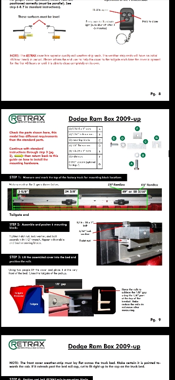

Thanks...not sure I am following you. I want to put my current Retrax cover into a bed with the Utility Group and want to make sure that the claps that hold down the cover don't interfere with the utility group rails. Sorry for being dense on the subject.
Here's a pic., that may help( may not be for your exact cover)

Understood. I just don't know if the rails will interfere with the clamps or the install of the retractable cover box that sits inside the bed.
Try below. Snicklefritz (???) had no issues.
I don't think you'll need these brackets, according to Snicklefritz_76 ...
