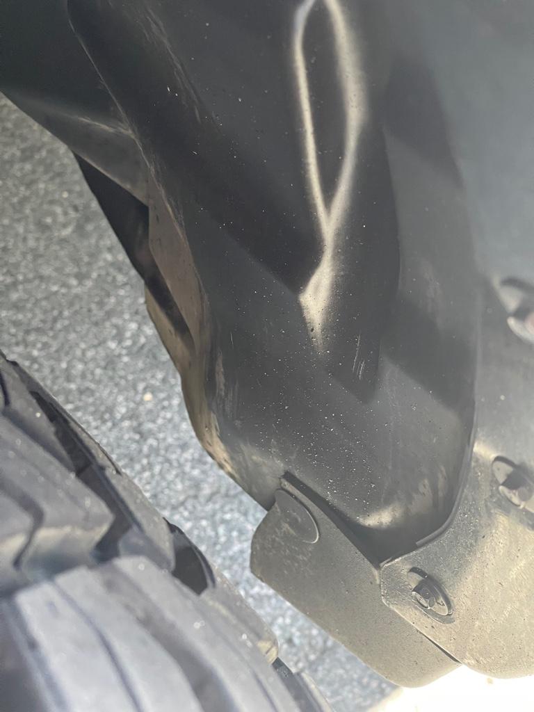

Turned out amazing!! Is it rubbing on full lock at the front mudflap? Mine did and I have a pretty easy fix which retains the mudflap and keeps the factory look of it.
here’s before and after. Turned out really clean and I’m super happy with it. Slight rub so tiny bit of modification needed. I changed to black emblems as well
before wheel height installed was just over 30” (supposed to be 31.9” uninstalled). With the LT295/90R18 Mickey Thompsons they measured 34.4” uninstalled and right at 34” installed
LOOKS GREAT! Like a brand new truck… Where did you have to trim?
Ya I’m super happy at Size of tire and how much of the wheel well it takes up. I didn’t do the trim work but they said they had to do a little and I looked at it after and the inside of the factory wheel well / mudguard looks to have been trimmed a super tiny bit. So I can’t answer at which point it was actually rubbing but it doesn’t look like it was anything much
Sounds like it is the same as I had mine. The inside lower corner of the mudflap. All I did was remove the mudflap, cut the corner where it was rubbing, bent back the metal bracket to give the tire more space at full lock, made a new hole for the clip and reinstalled.
