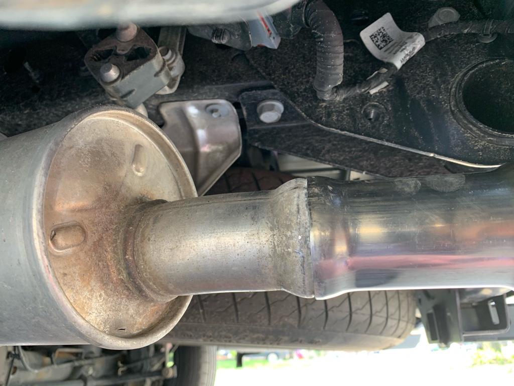

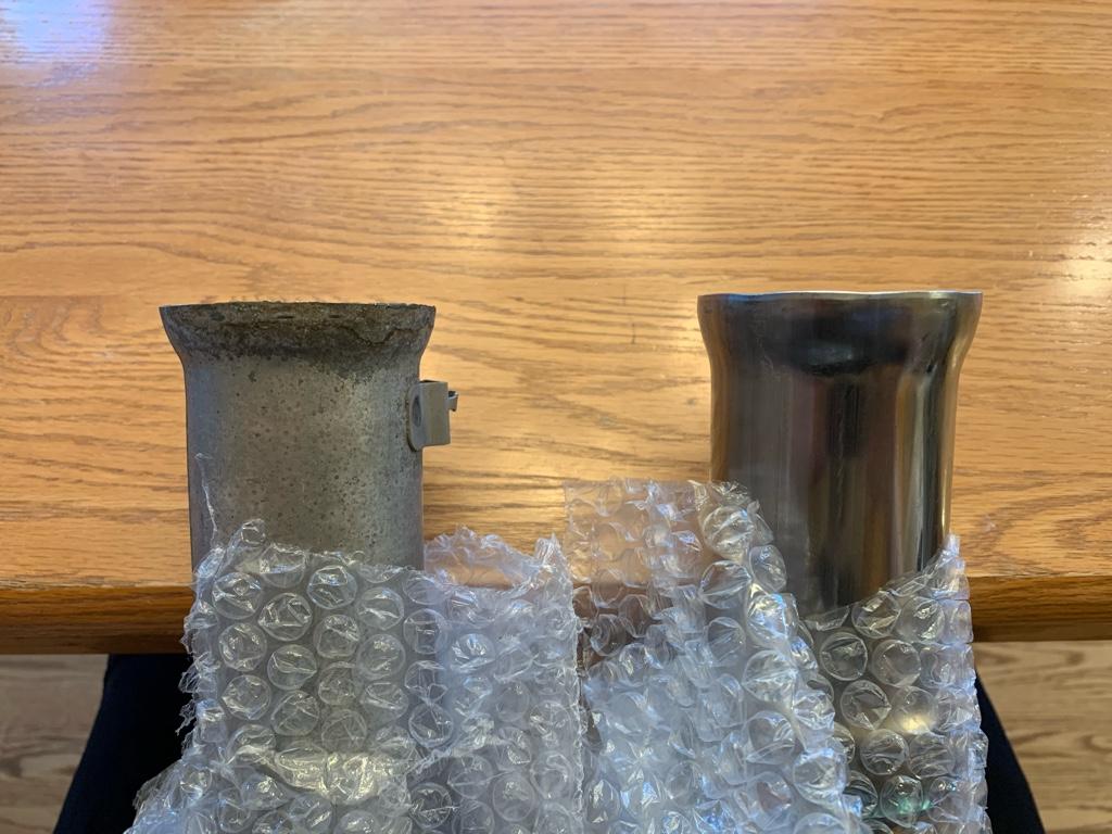

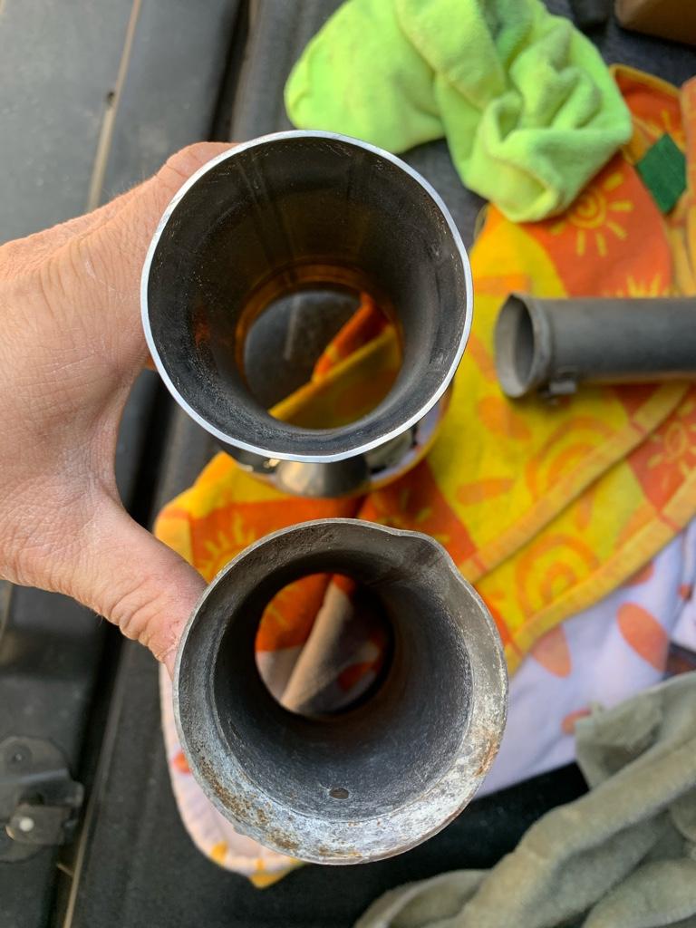

Went to install my dads B2 tips on his 20 Limited (eTorque) and running into fitment issues. I noticed his OEM tips have a small crimp. The B2 tips sit deeper on the OEM exhaust and even with the exhaust clamps cranked all the way down (wouldn’t tighten any more) the tips do not tighten up to the OEM system at all. The second you let go of the tip they flop down.
Sent pictures to Matt at B2 and he suggested notching B2’s or returning the tips altogether.
Anyone every have this issue or notice notches on their factory tips? My Rebel’s weren’t notched like this.
The tips fit fine on my Kooks system on my truck but for some reason they don’t fit very well on my dads factory system.
Are you using the OEM tip clamps? They should work just fine based on your pics. I had no issues with mine and they fit just like the stock tips. Weird that your's are different and that they don't remain in place once tightened.

We are going to try and buy new clamps. I suspect the factory ones are stretched out which is why the tips are notched. Not really sure why but it is what it is.
The clamps on my Rebel fit OK so new clamps may be the solution here.

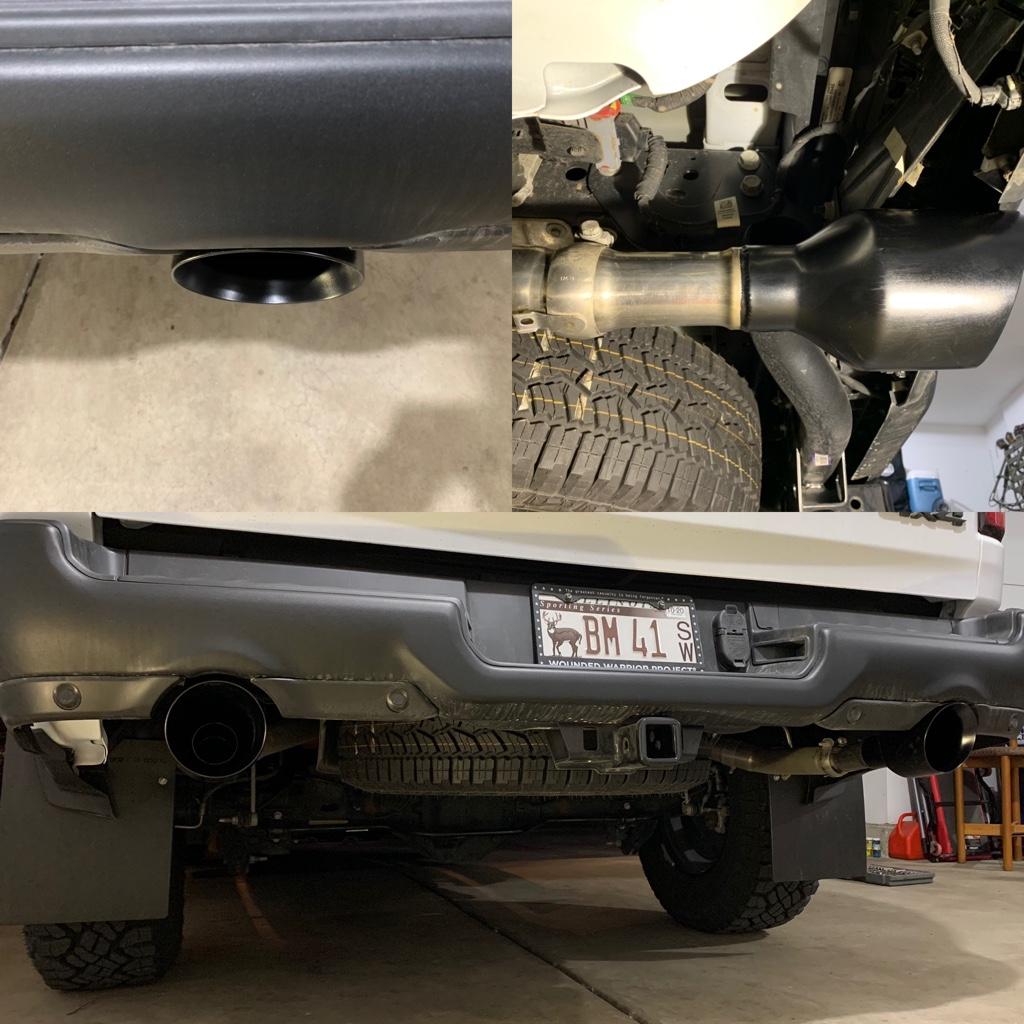

Well I got my stuff back from the powder coating shops and I have to say it’s looking awesome. I can’t put the resonator deletes on just yet, as I had been rear ended back in December and I need to go back to dealer to get an exhaust issue fixed. If the passenger side pipe is push all the way to where it’s suppose to be (there is a slit that is on the pipe that meets up to a alignment/stop rivet) my exhaust tip would be back about 2” under the bumper.
In the meantime I have installed the 5” tips which look great and way bigger then the factory black chrome ones. So I measured both, the factory tips are 4.5” OD and 3 3/4” IN and the B2 tips are 5” OD and 4 3/4” ID. So the B2 are 1/2” bigger outside and because the B2 tips are tapered in (rather then a rolled edge like factory the insides are 1” bigger)
Anyhow once I get the resonators installed I will post a video, just not sure when that is going to happen.
I’m glad I choice to get the reasontors powder coated as well as getting the tips fixed and recoated.

Bumping this. Just got my polished B2Fab tips yesterday and noticed the stock tips have a tab and holder opposite side of the bolt clamp, while the B2Fab tips have neither. Just un-bolt and bolt up the new B2Fab ones?
Yep! The tabs are not necessary.
