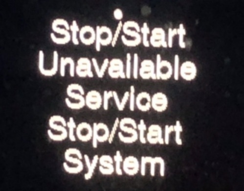

My 2019 Laramie just threw the same codes. Start/stop service and check engine light. I had just filled up the tank and drove around 3 miles and parked. Everything was normal until I came out the store and started it up then all the errors came on. View attachment 56834
yes exact same screen image
Had this exact same issue from the day I bought the truck, 2020 Laramie purchased in July. Start/stop becoming unavailable under various conditions, most often while idling (i.e. stop and go traffic, traffic lights, etc.). Occasionally a check engine light with code P0507, indicating higher than normal idle, would come on too. It turns out that the start/stop error was related to the P0507 code. In order to kick the check engine light, the truck had to be idling at 0 MPH at the higher idle for more than 30 seconds. The start/stop system was much more sensitive to that condition, causing the error without much more information. Luckily, there was a Star report related to the vacuum hose at the rear of the throttle body being installed incorrectly causing the higher than normal idle. Once the hose was installed correctly, the start/stop errors were fixed.
The start/stop system seems to require that a number of other systems are operating nominally. When one of those other systems go out of spec, start/stop become unavailable. For the longest time I was worried it was a problem with the system as a whole, luckily it was something as simple as a bad hose connection.
Around 20,000 miles check engine light came on with stop/start unavailable message in center screen. Engine started running extremely rough. Dealership plugged into the computer and cylinder #3 was misfiring. Turns out it was a faulty fuel injector. Truck was fixed and returned in 24hrs. Shop told me this was the 4th one they have seen.
It's moronic to have the software display a user message that says to service stop/start system when it's another system that's causing the stop/start system to become disabled. The software is more than capable of displaying a more appropriate message when a sensor detects an out of parameter condition. Why can't car manufacturer's just have the dic display a message that says "misfire on cylinder #3", instead of using trouble codes that require a code reader and the internet to interpret? That was actually a rhetorical question. We all know the answer to that.
