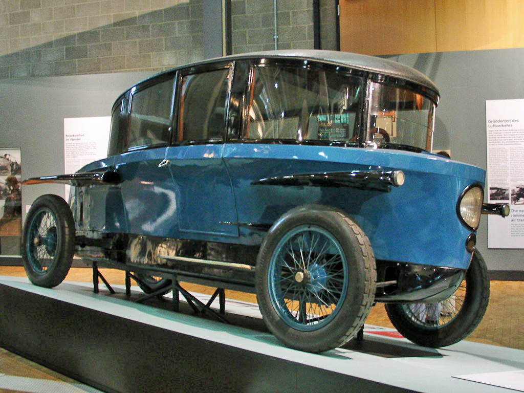

Most of the horsepower with normal use is used to overcome air drag. The old Citroen sedans were so aerodynamic that they could cruise at 70 mph using only less than 10 horsepower from the engine. With a truck you have a brick and adding an air dam helps as does smaller mirrors but it is really putting lipstick on the pig. Air drag increases exponentially with speed so there is 4x as much drag to overcome at 80 mph as at 40 mph.
Even towing a trailer it is the air drag that reduces fuel economy so very much and this is compounded by the distance of the front of the trailer from the rear of the cab of the truck.
