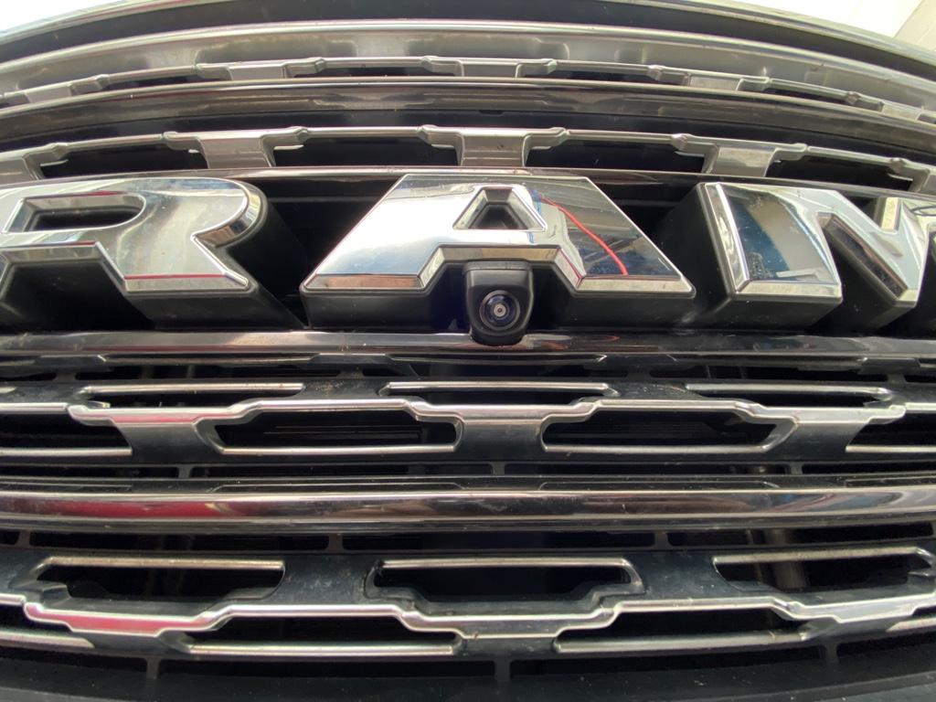

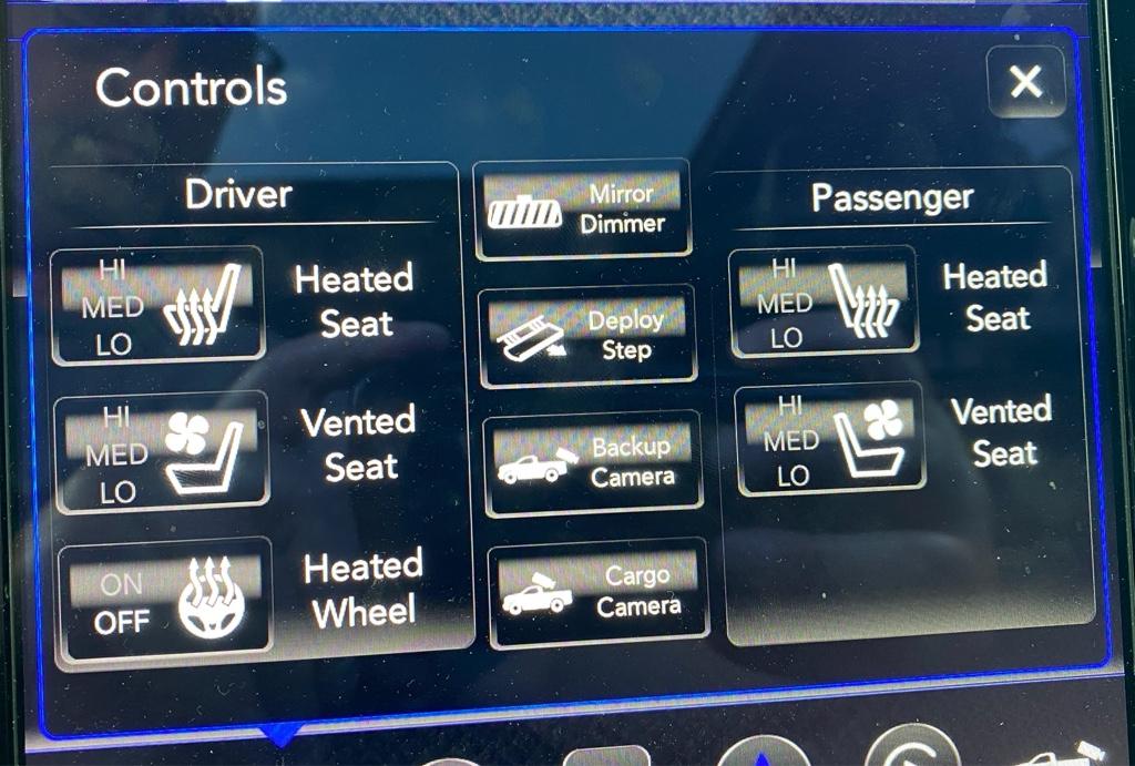

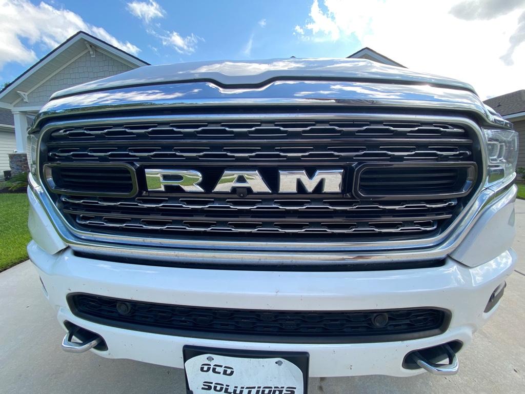

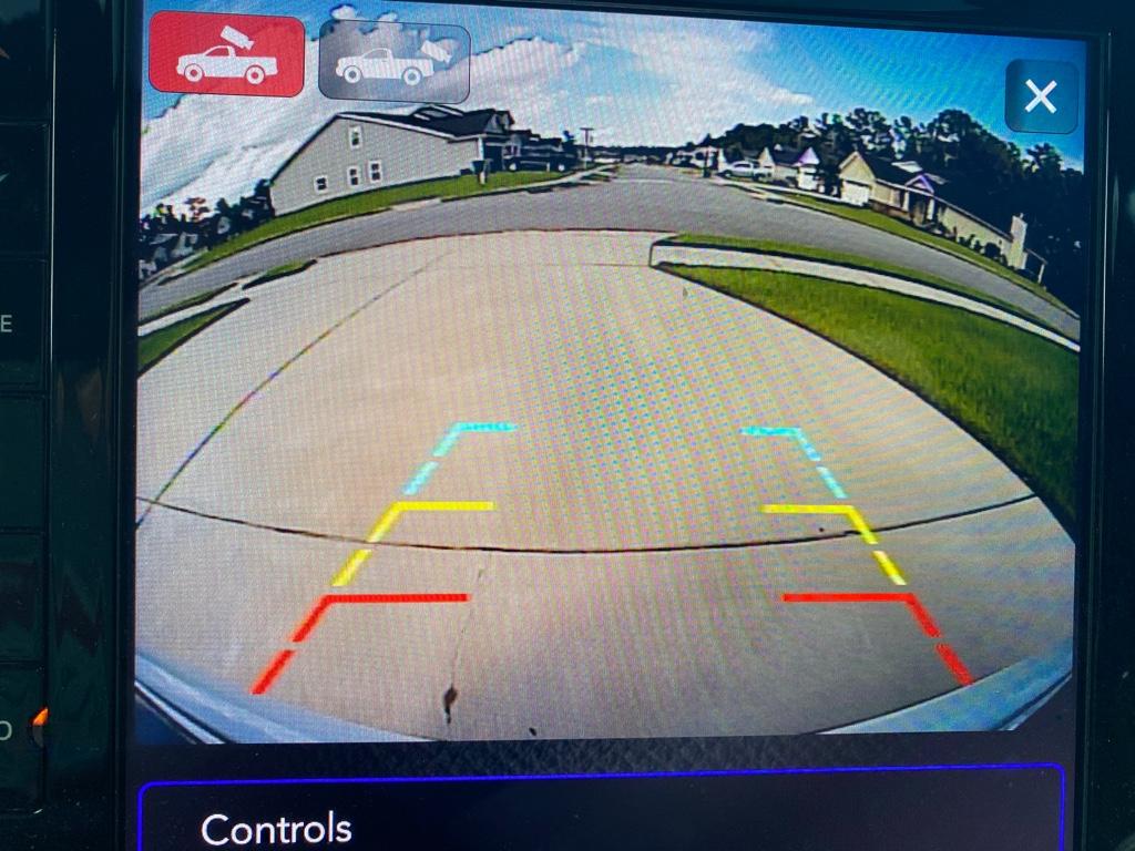

I followed the instructions posted on pg 26 and installed a front facing camera last weekend, had it all programmed in OBD and was just waiting for the video adapter to show up before I posted.
Other than the grill being far more complicated to take off than necessary, it was fairly simple and straightforward.
I lost connection to a bunch of the body modules, including the cameras, after unplugging the radio but they all came back after a few hours.
Not that it really matters but I would opt for a higher resolution camera if I was to do this again.
Did the same.
Now intermittently I get the blue screen saying camera is not available.
Loose connection somewhere?
