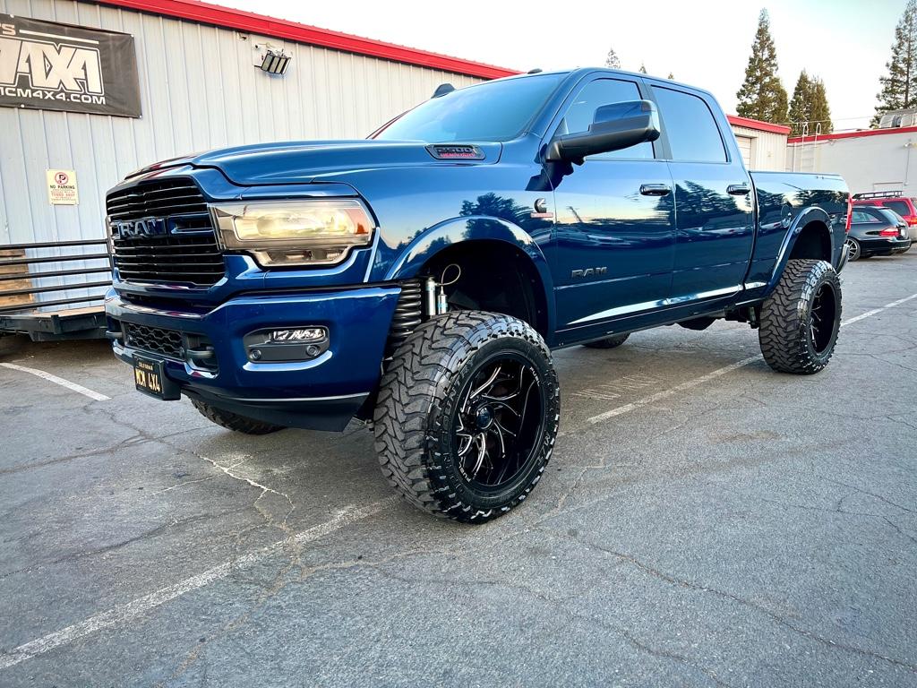

@vincentw56 Well you just killed my buzz… again! Haha Just kidding!! I really appreciate your help on these!!! One more question if you don’t mind since you obviously know a lot about these! Is there a way to recalibrate the adaptive steering system with Alfaobd (or anything else) to adjust for the 5” lift and 37” tires? It reacts to the lane markers much later since I lifted it. Thanks again, much appreciated!!!
"the 5” lift and 37” tires"???
Damn, bro. My neck aches just thinking about looking up that high. ;)
Hahahaha. How do you think I feel getting in and out of it??!! I own a 4 wheel drive shop so it makes for good advertising!! Lol
