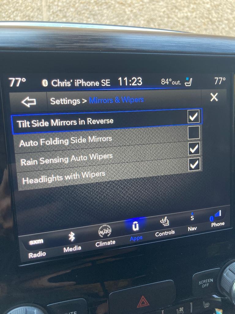

Has anybody turned in the auto-fold mirrors option in Alfa and had the option show up in UConnect? The option just beeps and turns back off when I try to enable it. But just thought it was interesting. Maybe a software update or something would enable it.
It won’t ever work. I had the developer add that setting to the list from the grand Cherokee settings (since they offer the feature). We figured out it is a limitation of the firmware in the BCMs used for Rams.
Gotcha. Well that’s a shame. It’s a nice feature to have.

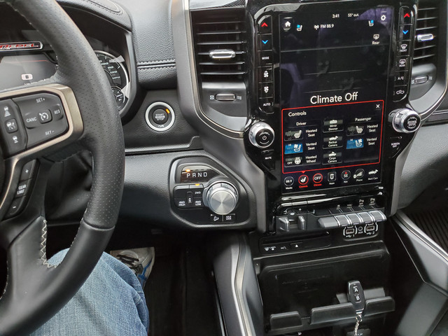

2nd - like everyone has asked and stated, the notorious ventilated seats. I had a 2019 ram Laramie with heated/ventilated seats and my 2021 Rebel only has heated seats in the front. Has anyone done this retrofit with the parts that have been listed to purchase to swap out before adding the values on AlfaOBD and getting them to fully work? If anyone has done this, is there a how-to or install diagram that can be posted as I would greatly appreciate it!

Regarding vented seats - yes, it can be done with the right parts. I've done it on my rebel.
The chmsl camera has not been successfully added yet. As far as I know we can't even purchase the mirror yet. It also won't work on the 12" because the camera is digital. The only unused camera input on the head unit is analog.
Well done! Vented seats are on my to do list. Just need to find a decent priced set of donors.
