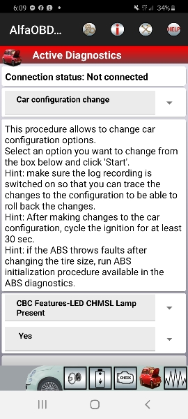

Where are the LED CHMSL setting listed under in AlphaOBD? I need to update these for sure, been having some random weird fob issues since swapping bulbs.
Connect to BCM figure out what ver you have 1-4. Then go to the third icon In on bottom right. Select the drop down Go to the bottom of the list and select set up vehicle or customer settings. Its Like the 2 or 3rd from bottom. Then another window opens. Scroll down to Whwre you start to see LED options. Right past the 10 led settings you’ll see the one for CHMSL. And then select... from that point select to YES. Then hit start, and changes will apply. Back out of Alpha and cycle your key. It may take an ignition cycle or two. Mine are enabled now, and still having some issues. I’m going to try a few things and see what happens. I’ll report my findings.
Connect to BCM figure out what ver you have 1-4. Then go to the third icon on bottom. Go to the bottom of the list and select set up vehicle or customer settings. Like the 2 or 3rd from bottom. Then another window opens. Scroll down to Whwre you start to see LED options. Look past them for CHMSL. And then select to YES. Then hit start, and changes will apply.
Thanks man!
