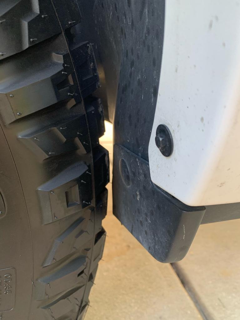

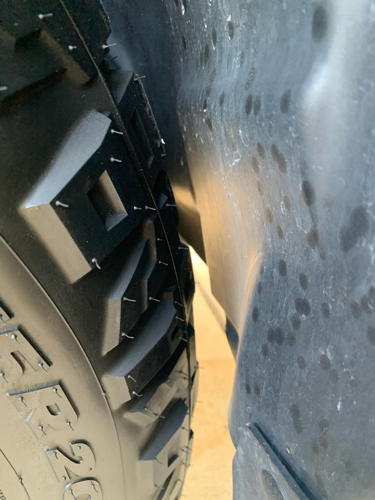

Nice.... How much fender clearance do you have have on the front fender on the rear of the tire with that tire size? Pics would be great. I am working on making the readylift upper control arms work for the air ride right now btw.
It’s close, but it doesn’t rub. It’s mostly just getting past the first piece, at full lock they have a bit more space.
