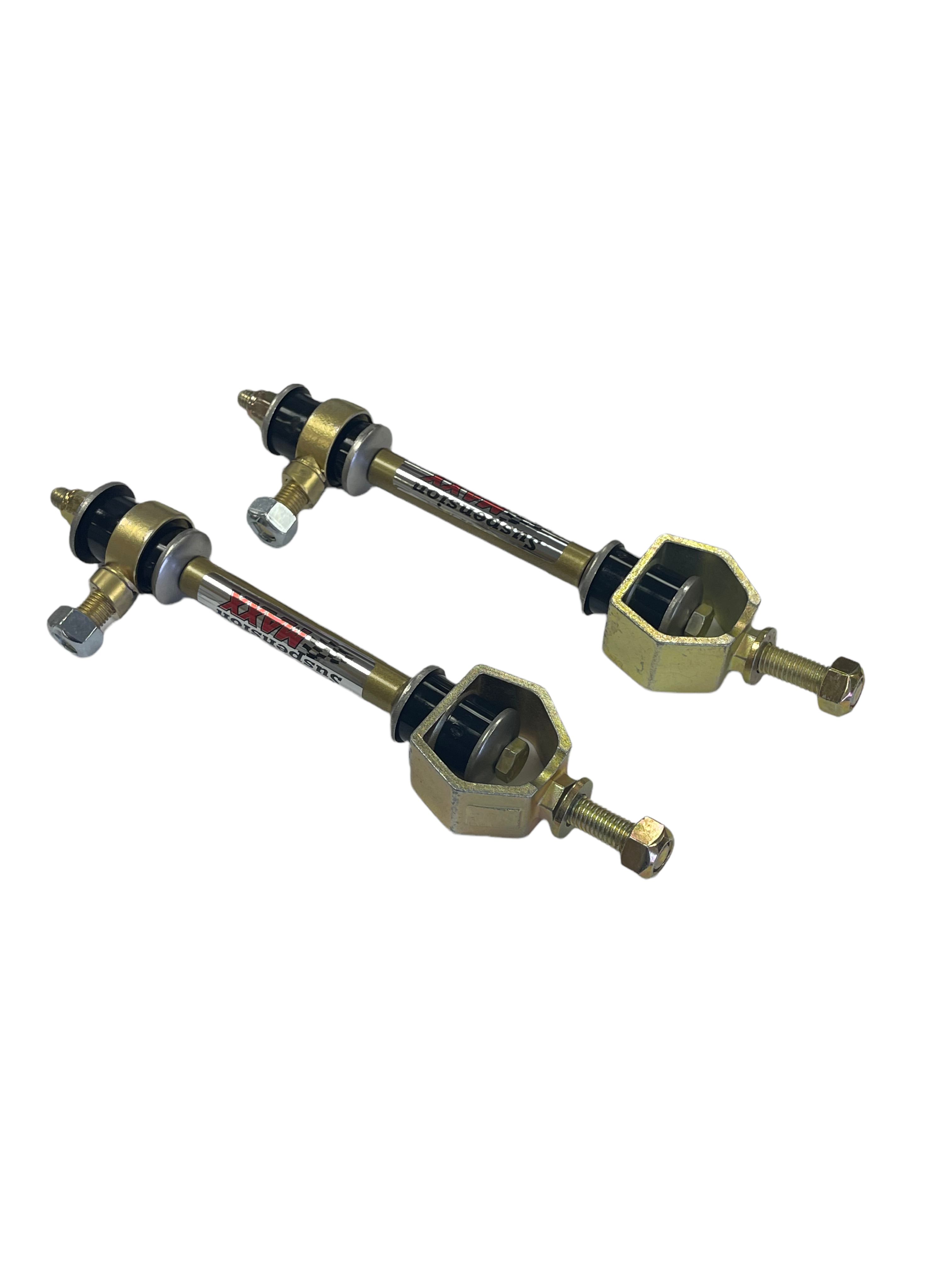

Update on my truck. Have been annoyed with what I'll call squared off small bumps and the jarring impact feel on the front end. I suspected it was sway bar angle and also my end links were making a tiny bit of noise. I installed the Suspension Max links and I should have done it sooner. Noticeable improvement in removing that jarring chattering feeling and the sway bar link clunk is gone.
